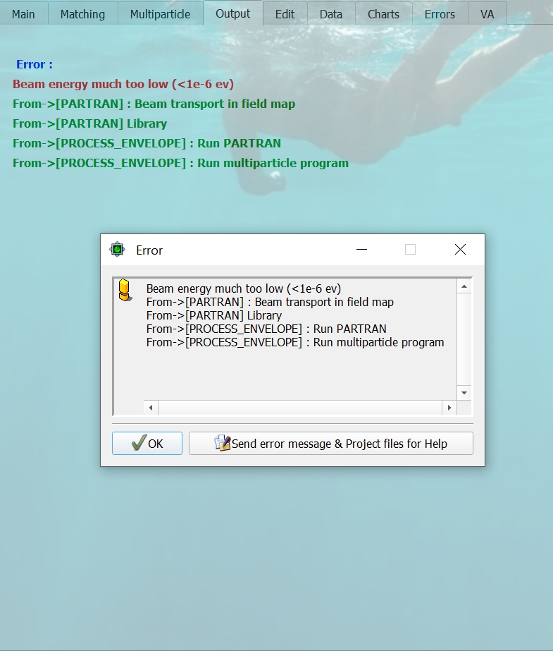

Dear Didier, one more problem with 3D RF field introduction into project.
Please, check my project (see attachment ) and answer me what is wrong and why program return next messages: ?
Regards, Vyacheslav.
Re: Field map implementation
Dear Vyacheslav,
Plotting your field, I see something very huge explaining why you have this kind of message. Probably you should reduce the ke parameter of FIELD_MAP from 1e6 to 1e-6, perhaps.

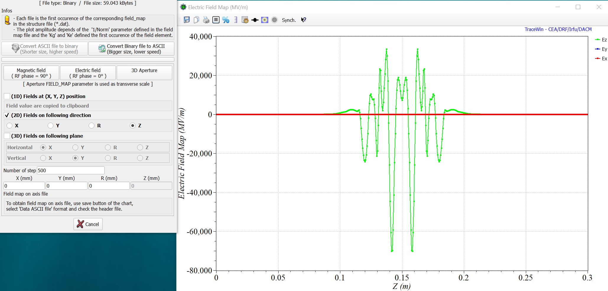

Dear Didier, unfortunately ke =1 did not help. Error message is still the same. What else can it be?
Dear Vyacheslav,

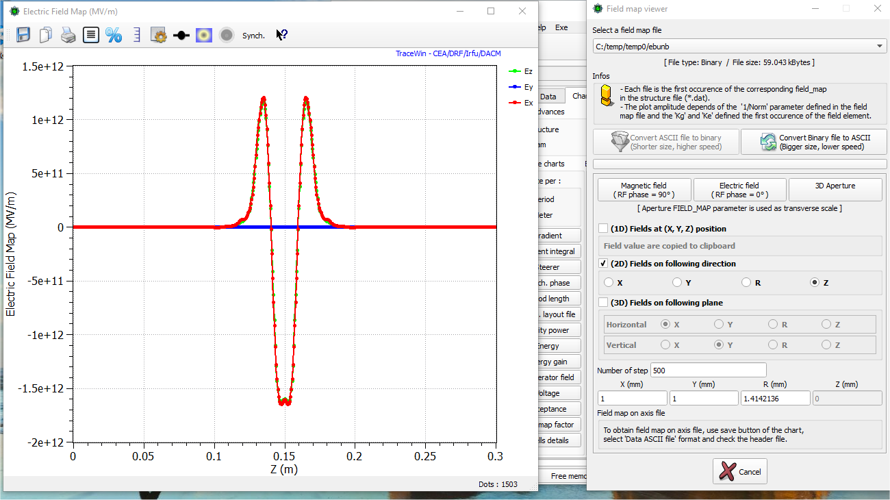

My field map plot has been done off axis with x=y=1mm and already gives Ex,y=10e+12 MV/m, so even with ke=1 it is still huge !
My felling is ke=10e-8, what work on my side with few losses, (Your field map is defined on +/-20 mm, which is smaller than the size of your beam)

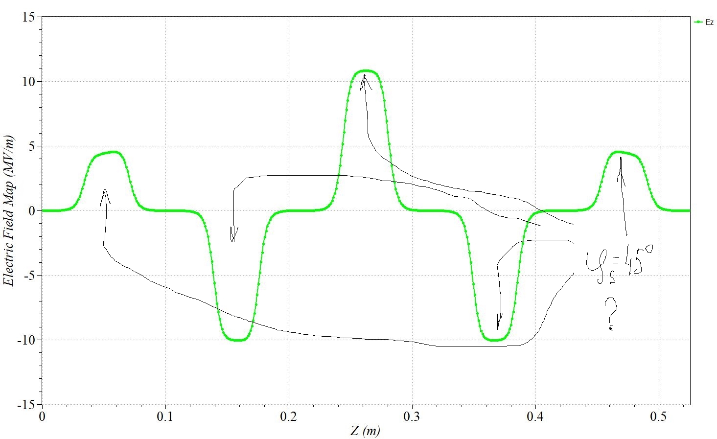

Dear Didier,Vyacheslav wrote: ↑Wed 9 Jun 2021 17:24 Am I right that Ez(x,y,z,t)=Ez(x,y,z)*cos(omega*t-kz*z), where Ez is the field map data value is a correct expression for the right-side of z-motion equation?
in this case how is synchronous phase defined? For example, it is need that in every accelerating gap (that is region with nonzero Ez field) synchronous phase will be equal to 45 deg.
If I use SET_SYNC_PHASE and put the 3rd parameter of FIELD_MAP equal to 45, will synchronous phase equal 45 deg all along the cavity?
If not, what shall I do to set synchronous phase as it is described above?
Vyacheslav,
Your definition of synchronous phase in a multi-gap cavity is not the one in TraceWin. You should read the definition of synchronous phase in the TraceWin manual. It is defined for the whole cavity, which is a bit like defining an equivalence between a thin gap and a multi-gap cavity.
