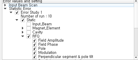

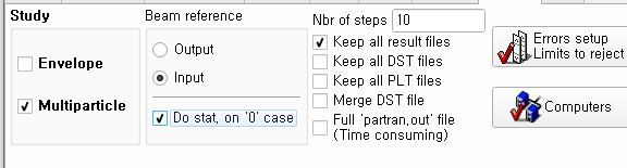

I try to do the RFQ error study in TRACEWIN with Toutatis.
When I check the "Statistic_Errors_1_PAR.txt' file after error study, it looks like the errors are applied to simulation.
However if I check the "Error_Datas.txt_#" file for checking the error setup, I can not see any data.
If I do the error study for quadrupole or cavity, I can see the error set up for each case but I can not see those setting at RFQ error study.
Is this bug? or Does not supported for the RFQ error study?
The attached files are the screen capture of my setup and the txt file is one of the 'Error_Datas.txt_#" file.

The errors applied to the RFQ are not managed by TraceWin but not by Toutatis, so they cannot appear in the file you indicate, but they are applied.

Thanks Dr. Didier, I understand the situation.
