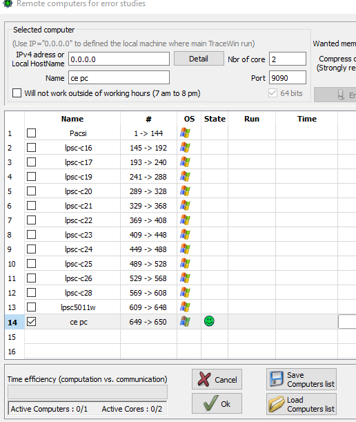

Could you send me your ini file for the wndows server?

The file is available here : https://mycore.core-cloud.net/index.php ... M4x3l5QyHS
Emmanuel
Re: Error study crashes
2 local machines only, that doesn't seem to me to be the ini file used on your windows server.
