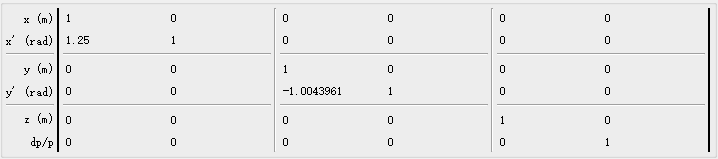

The transfer matrix of the third element (the edge of the dipole) is

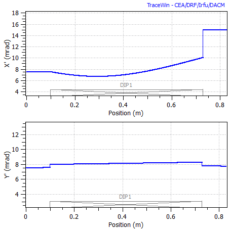

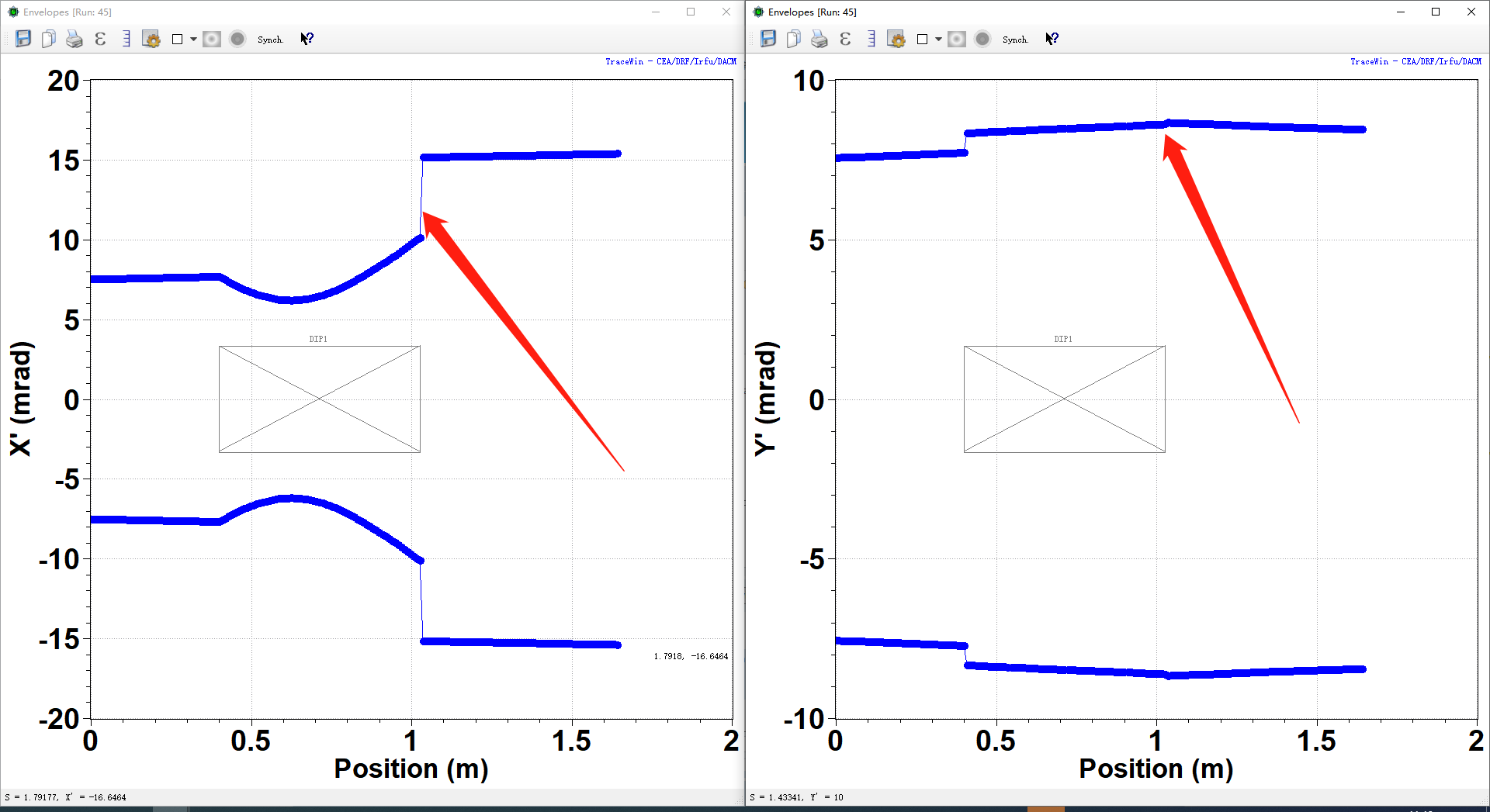

which means that it's defocusing in H plane and focusing in V plane. The question is, when I check the x' and y' envelop, there's only kick application in x', but without y':

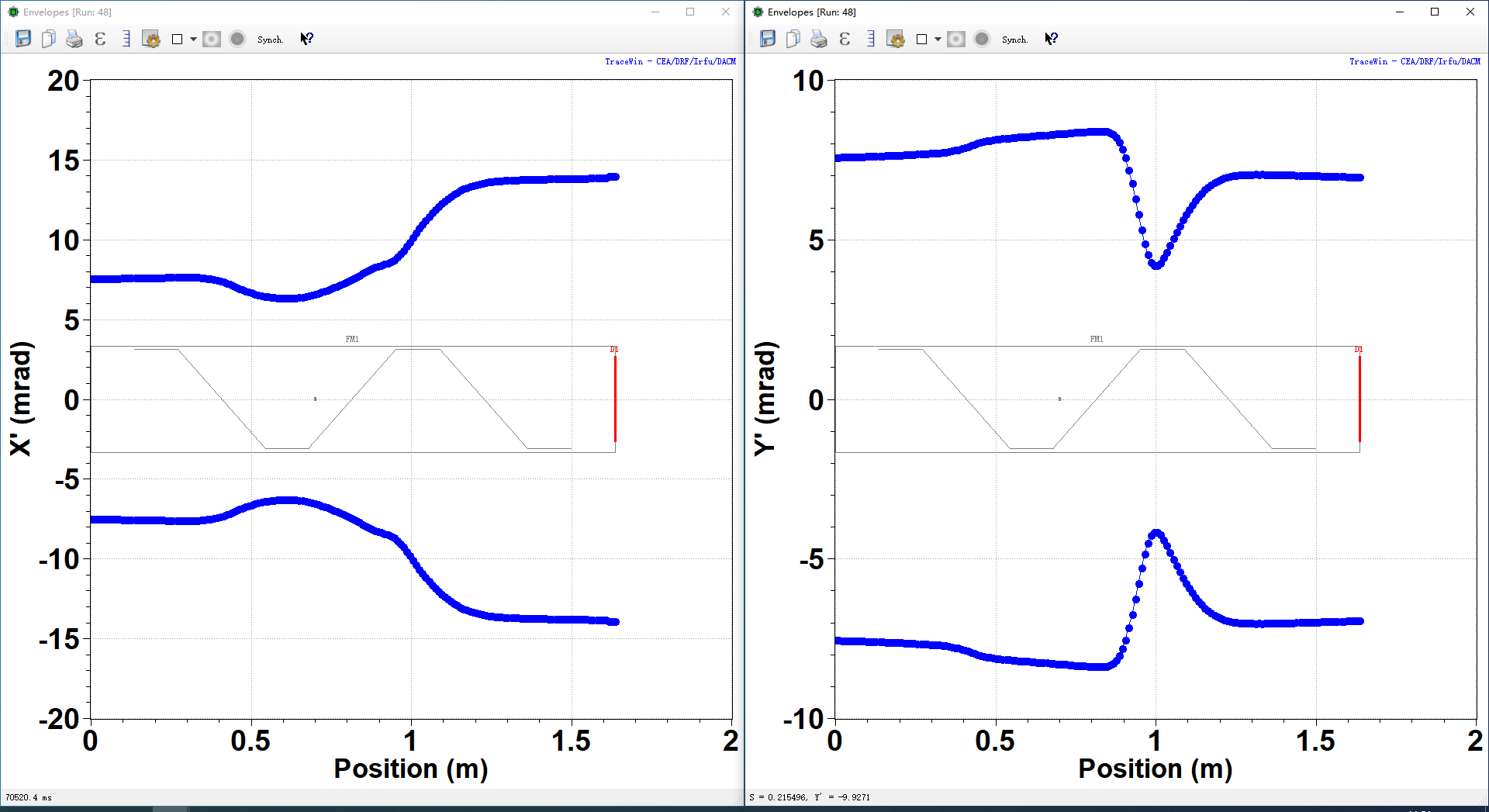

I tried the dipole field map and found the kick effect is obvious in both planes:

On my side I see kick in both planes, but I didn't have your project configuration. Please send me your project files (*.ini, *dat), otherwise complicated for me to check your case.

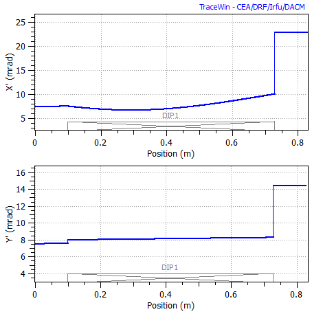

So, using your project, I find for 45° edge, the following behavoir and I found small vertical kick. And if I incease angle to 60° vertical kick become obvious.
