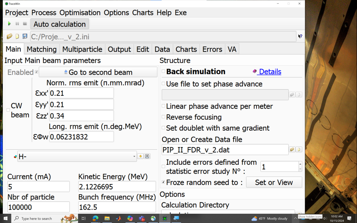

I am facing some resolution issues with TraceWin.
When I execute the program, the screen looks like the attachment to this post.
THank you
Abhishek
Re: Resolution Issue
Dear Abhishek,
Try this: Main menu -> options -> Font -> answer “Yes”. Close and restart.
If this doesn't solve the problem, answer “No” and select a regular font and size.
