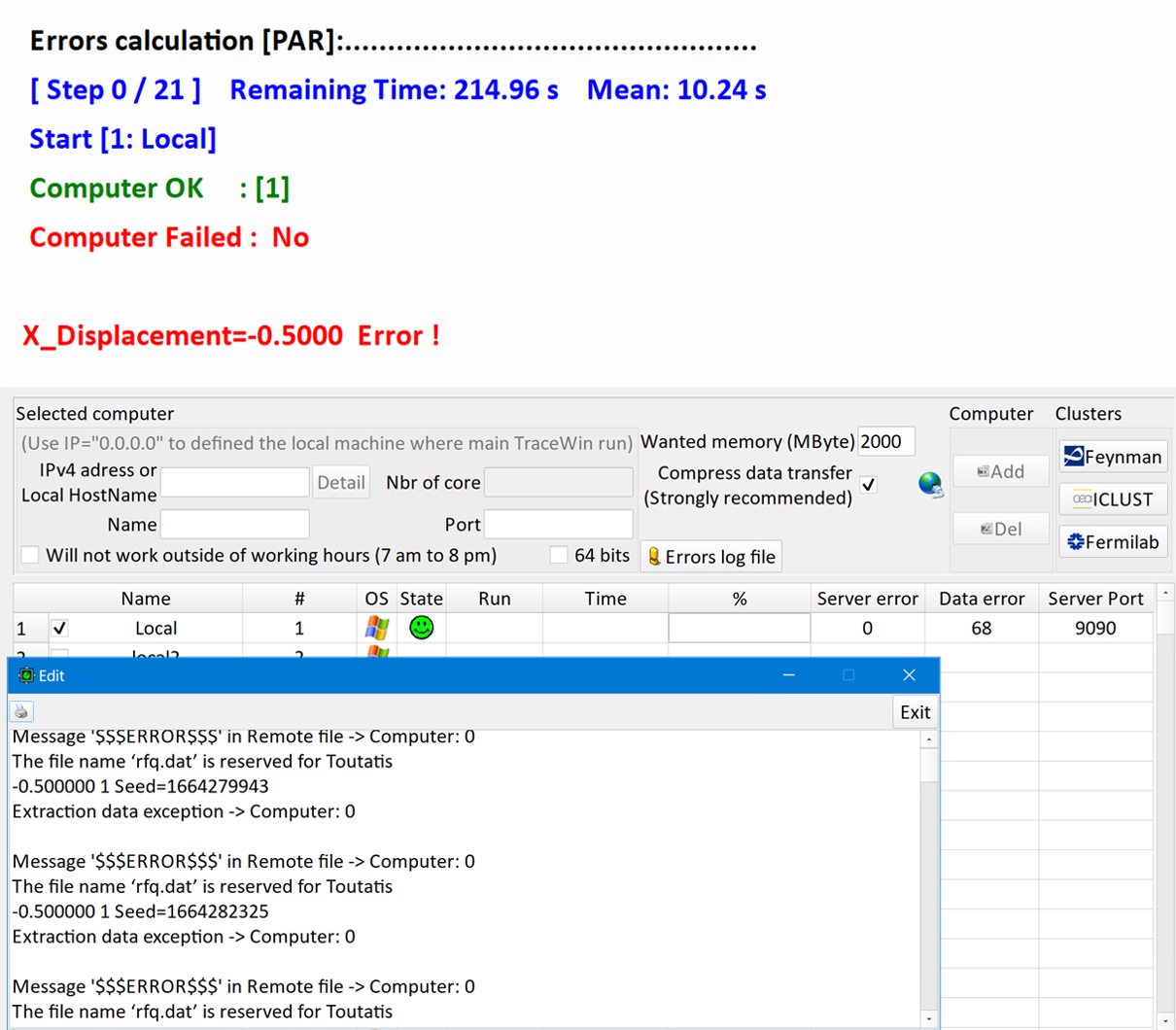

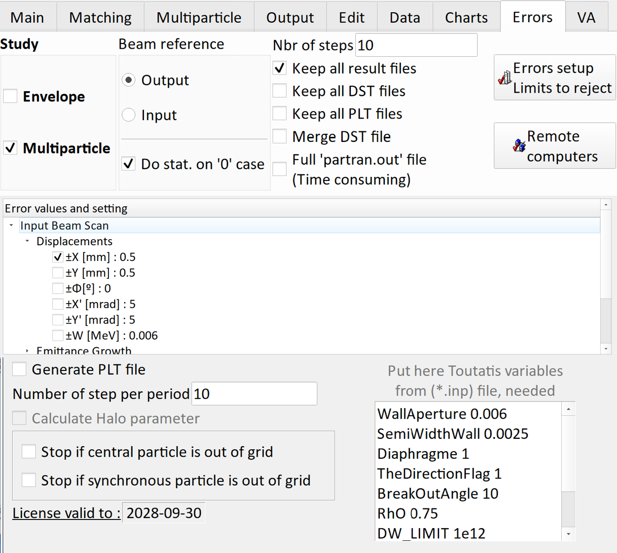

i encountered a problem when i performed RFQ error study in Multiparticle with Toutatis.
There is no error for DTL error study.
The setup and error messages are attached.

Dear Shuo,
You are probably using an old version of the examples supplied by TraceWin, because the file name "rfq.dat" is now reserved internally for the Toutatis module. You must either upgrade your code and therefore the examples supplied or rename your file describing the structure avoiding "rfq.dat".
This is also what the error messages you receive indicate.
