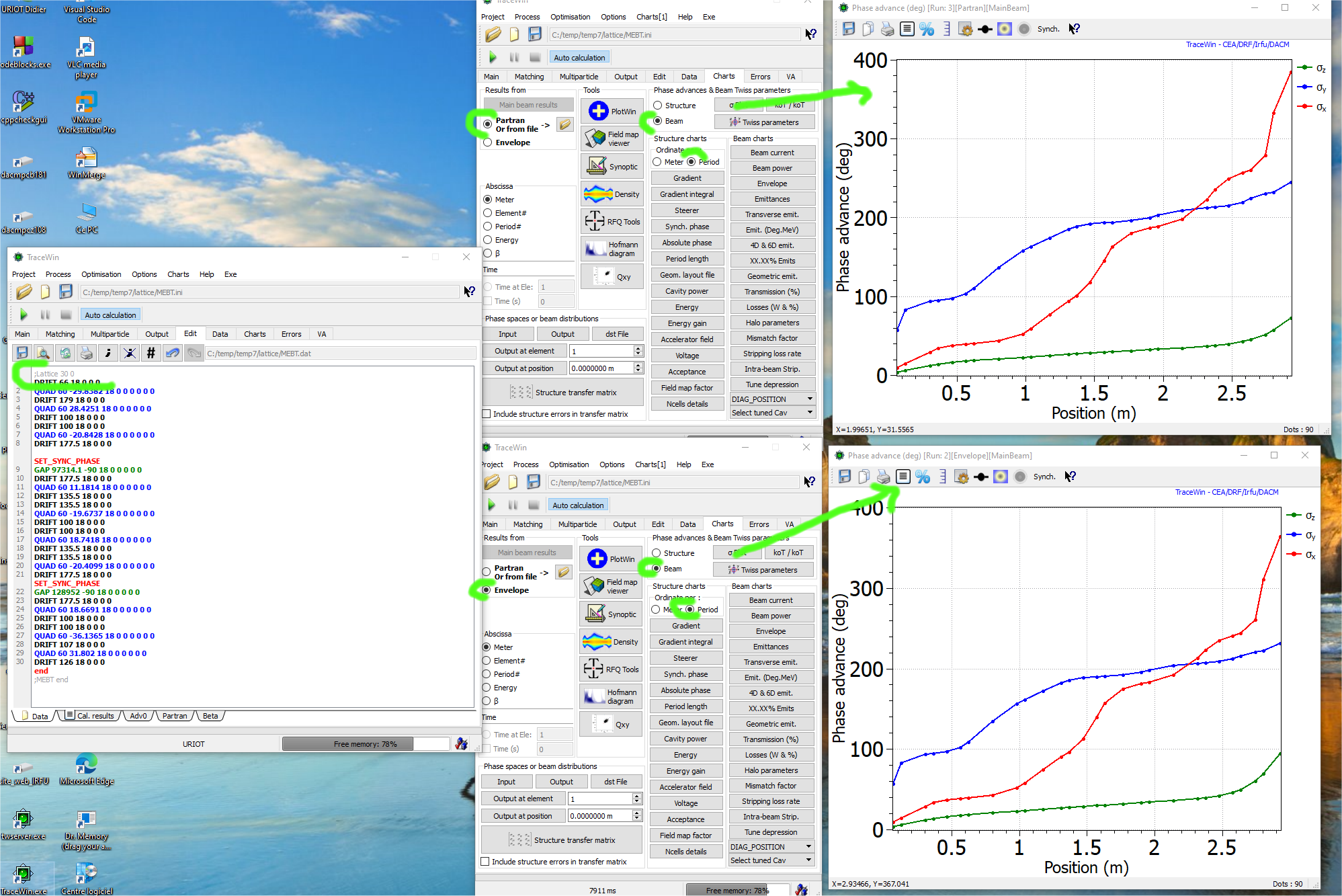

Figures 1 and 2 should normally give the same plot, and that's the case with me. In any case, I understand your problem, i.e. the discrepancies between envelope phase advance and tracking.
If I do the same as you, but using TraceWin (see my image for the method), I get a smaller discrepancy than your last plot.
Now, it's normal to find a difference because the envelope calculation calculates the phase advance at each calculation step, whereas in tracking it's based on an average made between the input and output of the element. You have to cut the elements into small pieces to get something very close.

Ok, I think I understand now. On my side, using my method, both give the same results, because in both cases I use phase advance values from the partan.out file. You're mixing phase advance values with beta functions, so I think you're confusing the beta function with the phase advance.
