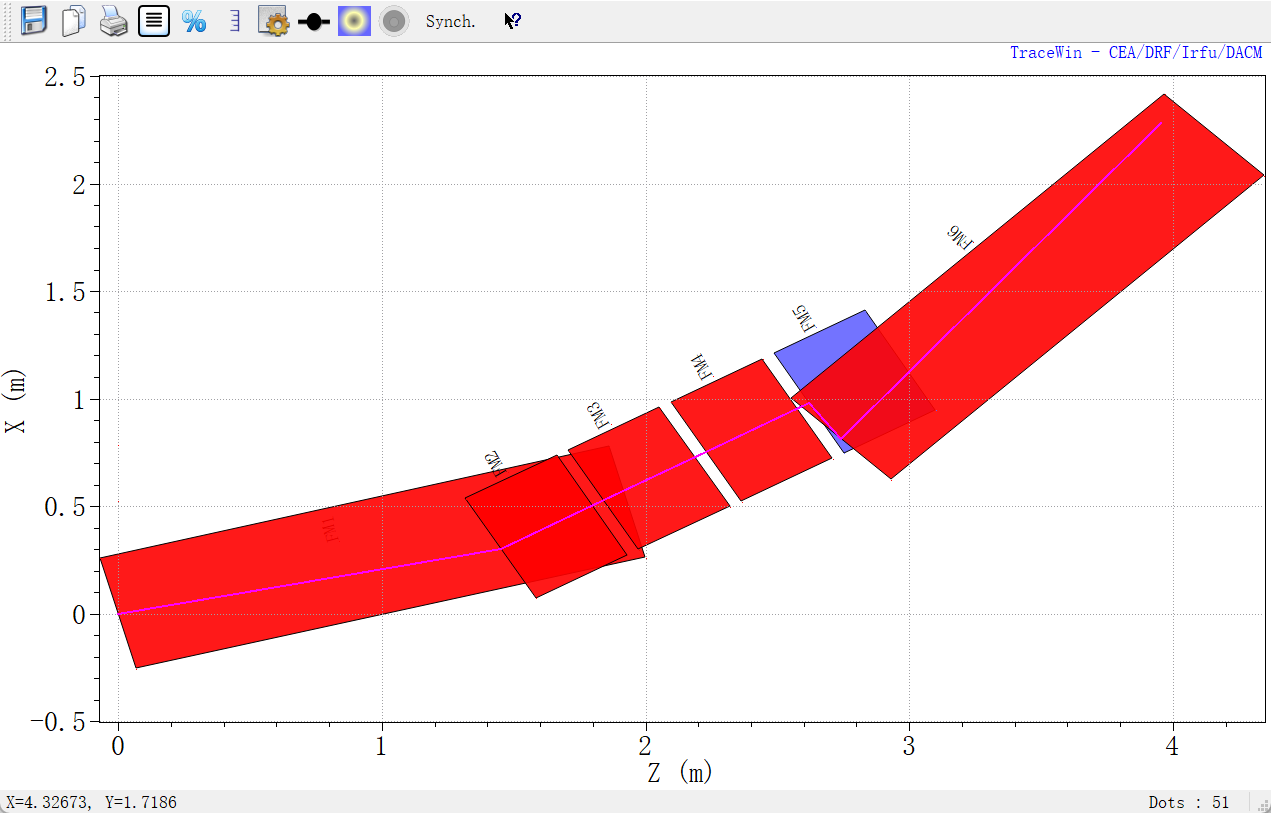

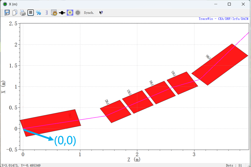

1.When constructing the combined magnetic field, I noticed that the starting point of the first field is automatically set to (0, 0). To maintain the planned position of my first field, I used a placeholder field named "defa." Does this method work as intended?

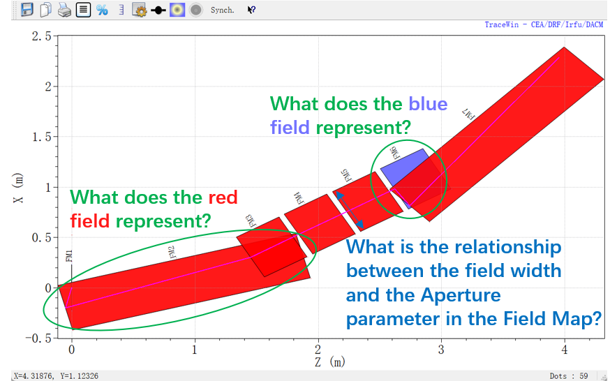

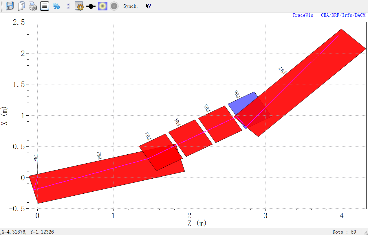

2.In the synoptic output of the combined field diagram, what do the red and blue regions represent?
3.What is the meaning of the "Aperture" parameter in the Field Map? I noticed that it seems to influence the width of the field in the synoptic diagram to some extent, but I couldn’t discern a clear pattern.

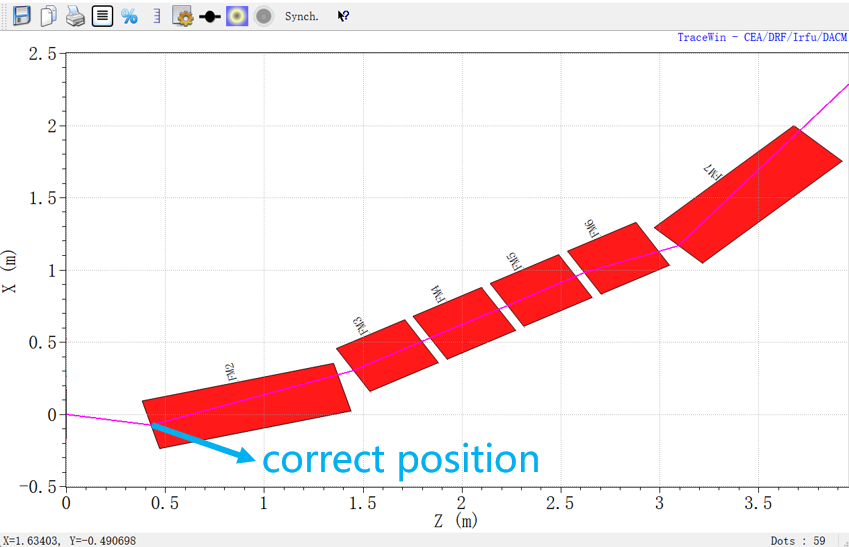

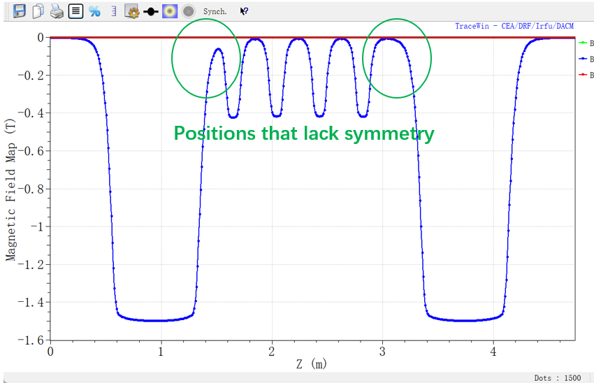

4.When attempting to construct a short beamline segment, I found that overlapping fields result in a distorted beam trajectory. Additionally, the field exported via the Field Map Viewer lacks symmetry. Could this affect the beam transport calculations? How can I adjust the settings to achieve the expected results?

Figure 1. Combined field without the "defa" placeholder field.
Figure 2.png (67.72 KiB) Viewed 4885 times
Figure 2. Combined field with the "defa" placeholder field.

Figure 3. Questions about the combined field diagram in the synoptic output.

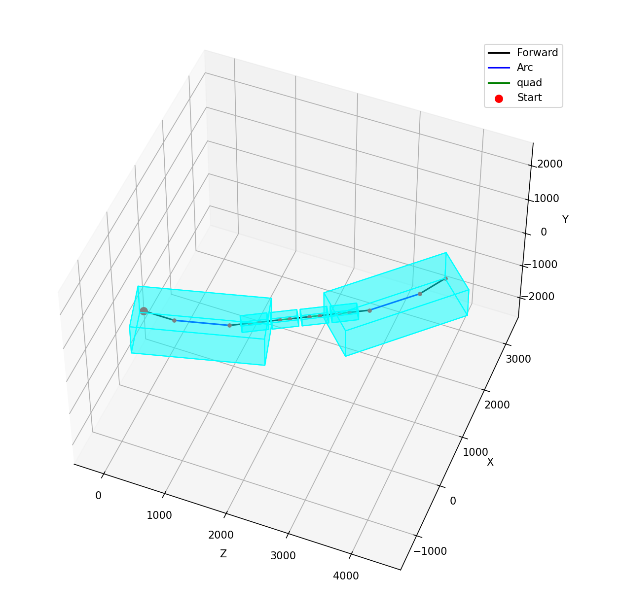

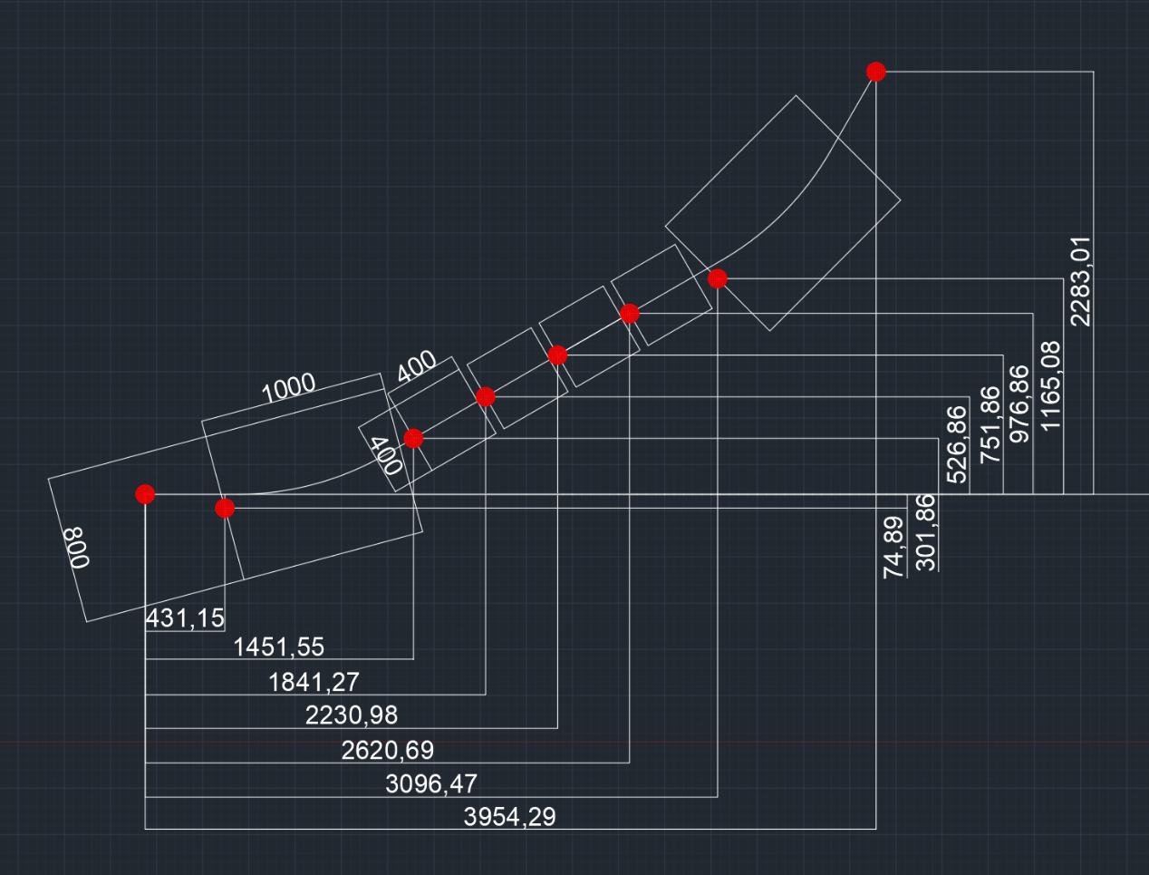

Figure 4. Expected beam trajectory (2D and 3D).

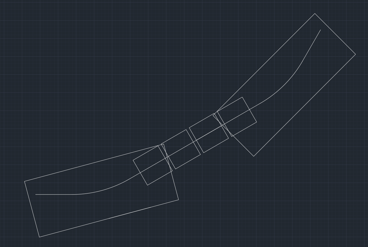

Figure 5. Beam trajectory output from TraceWin.

Figure 6. Field distribution output from the Field Map Viewer.

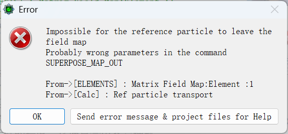

I'm not able to check yur project, because I have the error "'Impossible for the reference particle to leave the field map, Probably wrong parameters in the command SUPERPOSE_MAP_OUT"

2 - Red is for dipole and blue for quadrupole, it's very strange because your first 3 quad are red, I have to check when you send me a project wroking
3 - The particles are lost when they leave the chamber aperture defined by aperture parameter. The field plot can also be limited to this value if it is smaller than the actual size of your field map.
4 - No, and this field is not the one seen by the reference particle, it's the field following a straight line, so it doesn't really correspond to your case where the trajectory is curved.
At last point, looking at the synpotic plot, I think the position of your last dipole is not correct. It doesn't correspond to what you want to simulate and, moreover, the zig-zag of the reference trajectory shouldn't exist.

4. If "the straight line doesn't really correspond to the case where the trajectory is curved," does it mean that the trajectory output by the Field Map Viewer and the synoptic is that of the reference particle or the straight line? When I tried modifying the kb factor in the Field Map command for the dipole magnet, a very small kb factor caused the beam to deviate from the center, leading to particle loss. It seems the trajectory does not bend correctly and remains a straight line.
In fact, I believe the position of my last dipole is correct because I created a 2D model of the combined field externally using CAD software.

I have verified all the field starting coordinates and the beamline start and end coordinates, which are consistent with the synoptic output. The occurrence of the "zig-zag of the reference trajectory" can be explained if the reference trajectory always connects the starting coordinates of each field and finally connects to the coordinates entered in the SUPERPOSE_MAP_OUT command.
I think the main issue now is that I don’t fully understand how the reference particle is defined in the combined field, especially when the dipole magnet bends the beam.

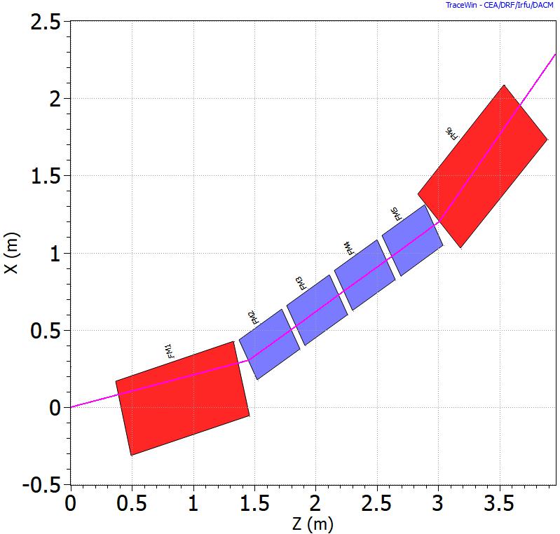

I've updated TraceWIn to correct the colours of the elements that weren't working very well in your case (blue:quad, red:dipole).
I've also changed the way I draw element sizes in this latest version and try Bend size =0.8 and Quad size = 0.4 (this is a fraction of their respective apertures), you should get things closer to what you expect. Except for the fourth quad. In my opinion there's a problem with it because it comes after the last bend and not before as indicated in the dat file. It's going to be quite complicated, so I suggest you reduce the length of your dipole elements. It will normally be easier to understand.

4- In the Synoptic plot, no calculation is made on the particles, so I don't know the trajectories and I just draw a straight line between the entry and exit of the map.
I still say that the zig-zag is not normal. Please reduce the bend field map lenght, ca will simplifie everything.

I have noted your updates to TraceWin, and they are highly effective. With the ability to distinguish between quads and dipoles, the shapes and colors are now displayed correctly. Thank you for the improvement!

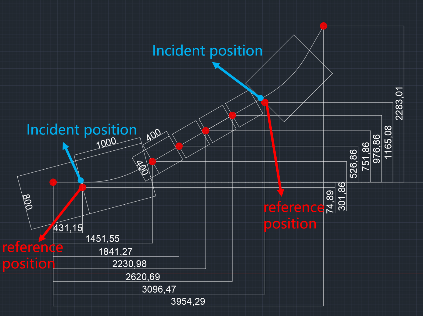

Regarding the use of the empty card, the reason I included it is that when the starting point of the first field is not at (0, 0), omitting a placeholder for this field results in the Synoptic plot forcing the first field’s starting point to (0, 0).
Field_map_without_emptfield.dat
(982 Bytes) Downloaded 251 times
Using an empty field as a placeholder ensures that the field distribution matches the expected geometry.
The issue with the project failing to run might be related to updates in the newer TraceWin versions. It seems that the newer version has added some checks for particle exit information specified by the SUPERPOSE_MAP_OUT command (which may not have been present in older versions). After updating, I encountered the same error that you described.
To help clarify the geometry I aim to construct, I have detailed the particle trajectory and field distribution in a CAD diagram and modified the .dat file accordingly.
fieldmap.zip
(41.22 KiB) Downloaded 214 times
I am unsure how to adjust the SUPERPOSE_MAP_OUT command in the superposed field model to resolve the error. I suspect the issue arises from a mismatch between the particle entry point and the field reference point for the dipoles, which may also explain the problem with quad recognition in this project.
Does TraceWin require the particle entry point to exactly match the field reference point when importing field maps? If there is a mismatch, how should the .dat file be configured to ensure smooth execution?

Now clearly here the particle entry point must correspond to the centre of the field map of the last dipole and that's not what you want. So the solution is, as your elements don't overlap after all, to do the following:
SUPERPOSE_MAP_OUT .....
SUPERPOSE_MAP ...
FIELD_MAP ...
DRIFT
SUPERPOSE_MAP ...
FIELD_MAP ...
DRIFT
SUPERPOSE_MAP ...
FIELD_MAP ...
DRIFT
Each element is independent and can be positioned exactly as you wish.
