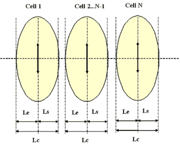

The only drawback with NCELLS and IH-DTLs would be, that - afaik - the ratio of drift tube length to gap length is fixed to be 1, see the manual:
Nevertheless, this should probably be a more accurate approximation for IH-DTLs than simply using the thin gap approximation, right?
Regards
Lee
This thus leads to some deviations, since in reality the outer gaps often have a different length than those in the center of a cavity.If m=1 (=π-Mode):
For cell2 to N-1:
Le=Ls=1/4 βλ,
Lc = ½ βλ,
EoT(2..N-1)= EoT.(1+kEoTi).(Ti/Ts)

- image185.png (39.07 KiB) Viewed 10809 times
Re: IH structure
Dear Jonathan,
Using Bg as following, cell length can evolve according to velocity
That should be good enougth to simulat IH-DTLs cavities ?
And outer cell lengths can be adjusted according to dzi and dz0 parameters.Geometric β
> 0: all cell lengths are the same according to βg
= 0: cell lengths are set according to beam velocity
< 0: cell lengths are set according to an initial beam velocity –βg, which is increasing from cell to cell according to θs and EoT parameters.

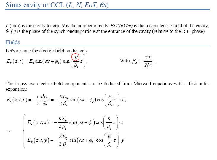

Dear Didier, is it correct to use five CAVSIN elements to simulate 5-gap IH cavity?
Explain, please, what does absolute and relative theta_s mean? I do not understand that clearly.
One more, how is K parameter defined for CAVSIN element?
- изображение_2021-10-11_140154.png (50.34 KiB) Viewed 10471 times

Dear Vyacheslav,
This element and the equations used are fully described in the manual.
In particular, I can read, K = 2ϖ/λ = ω/c
So,I don't know if this element initially defined for CCL type cavities can be used for IH structures. I think that probabbly the best for you is to use the 1D field map (FIELD_MAP) to define the field on the axis of your specific structures.
Relative phase means that the RF phase of each cavity is independent, absolute means that they all have the same reference defined at the beginning of the machine.
