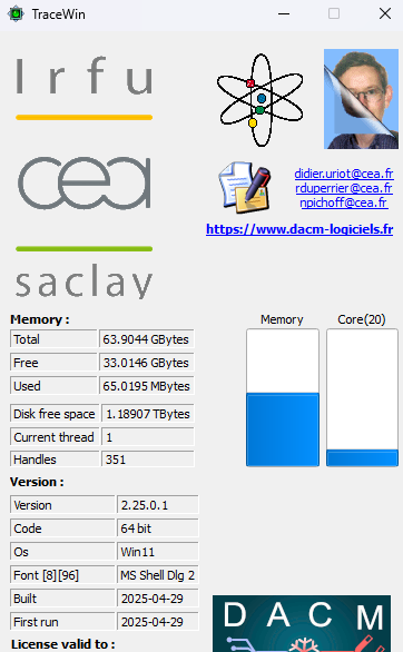

I am getting GUI error every time using TraceWin lately. Windows 11 build 26100
Screenshot 2025-05-05 220605.png (6.99 KiB) Viewed 3714 times
To reproduce:
- Run any simulation
- open any chart
- close chart
- open new chart
--> GUI Error
This happens every time. It is not dependent on the project, happens also with example files.
Opening a second chart while first chart is open will work.

Re: Critical System Error ... Windows 11
Dear Hendrik,
I've had a number of reports of this problem on Windows11.
Unfortunately, I don't see it myself, so it's a bit complicated to fix.
Having said that, last Friday I put out an update, which can only be accessed by downloading from the website.
So, if your version was downloaded previously, please try this latest version and let me know if it corrected the problem or not.

yes, that version (04-30) works for me, thanks ;)
