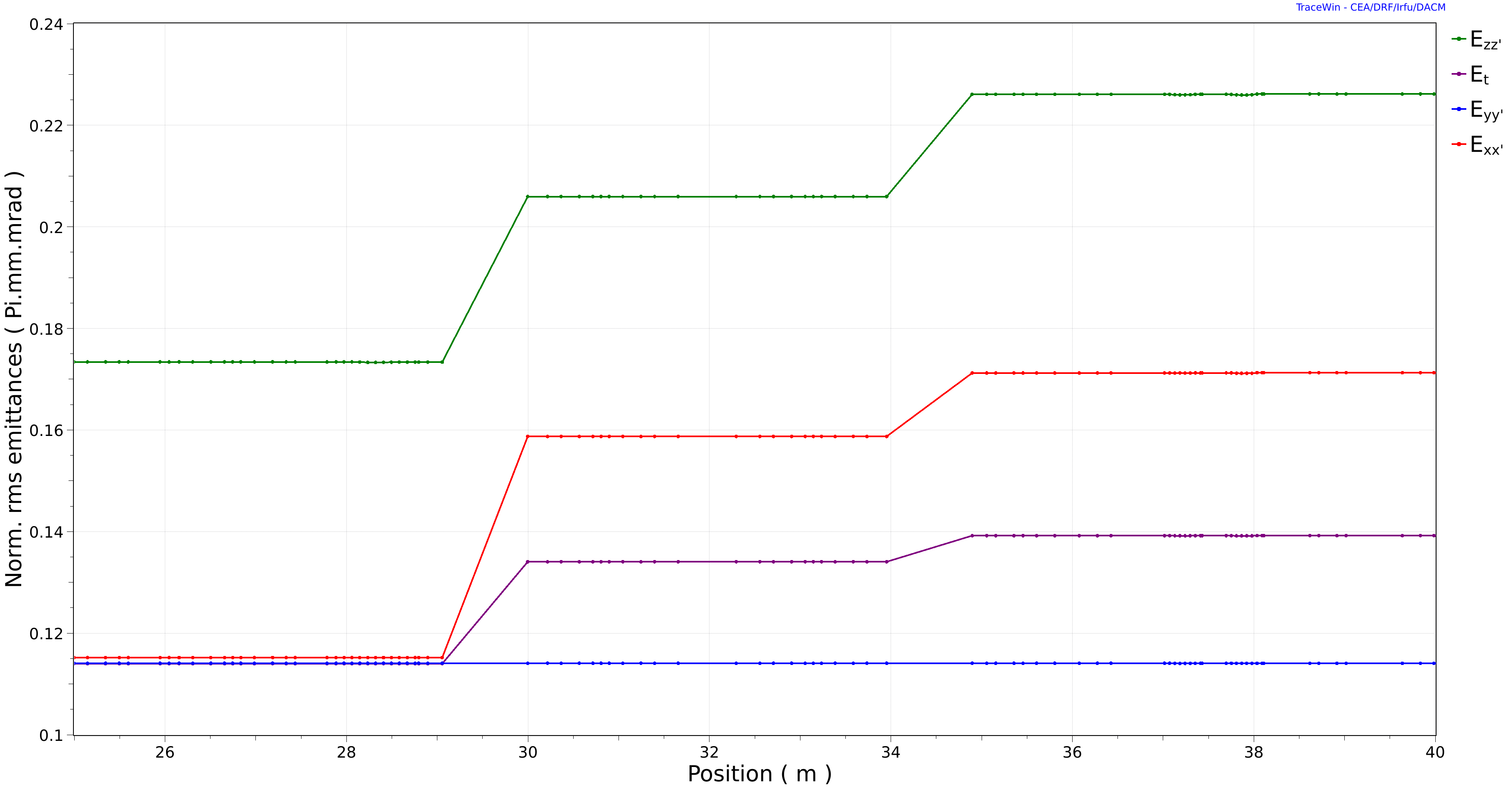

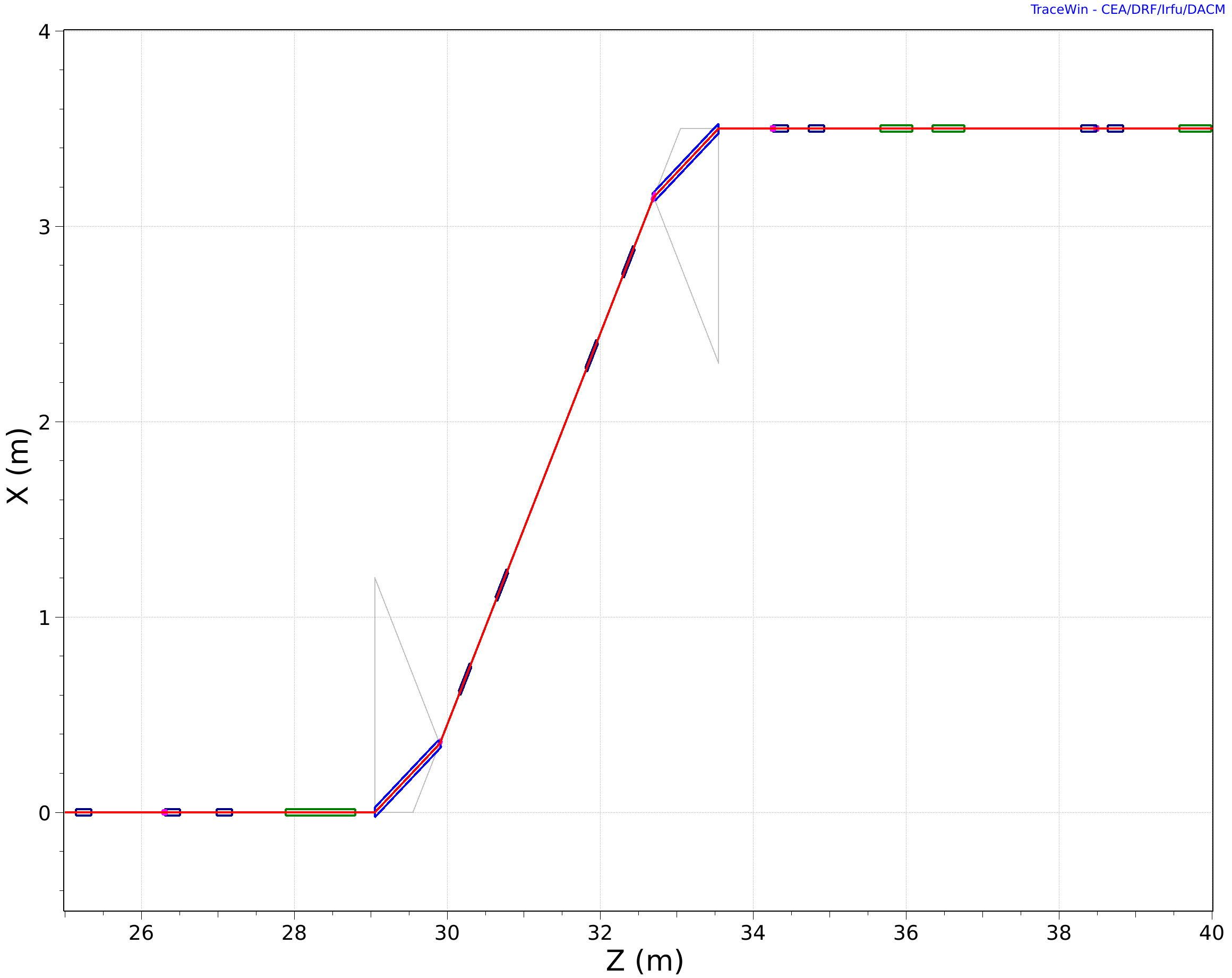

I have noticed a substantial increase of the emittance in dipoles.
The attached pictures show:
- the evolution of the emittances (envelope mode)
- the synoptic of the line
What is the explanation for the emittance increase?

Hi Aurelien,
Please attach your project files, because otherwise it is hard to understand what exactly you are doing.
But my first feeling is that your line is not achromatic and you see coupling effect between the longtidal and transverse planes.

In fact, your line seems achromatic, because achromatism is a first-order calculation based on matrix transfers. And so it always neglects the space charge.
Now when you include the space charge, this notion of achromatismis no longer relevant. With space charge you have to use something more physical and measurable, like emittances or beam position, which are phisical values that will depend on the real achromatism.
So, a solution for example, to get around this limited theoretical notion is to replace "DIAG_ACHROMAT(1000000000) 105 1 1 1" by "DIAG_EMIT(1e8) 105 0.13 0.13 0.195". But you could also try to work with beam centroid putting some energy error at the line input.
But you should know that with the space-charge it is almost always possible to get something perfect.

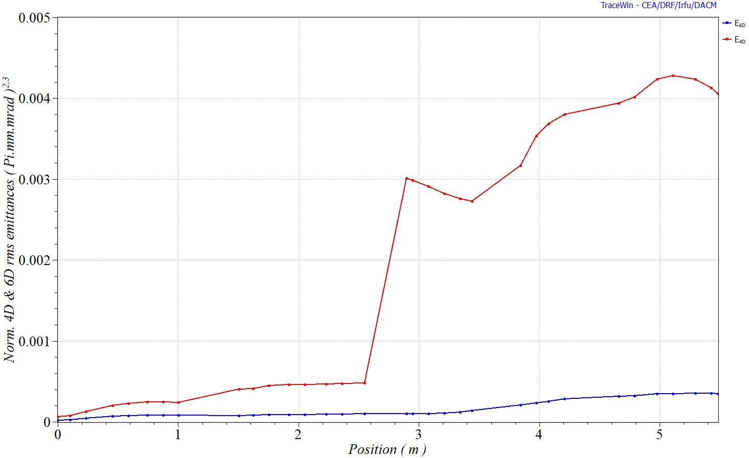

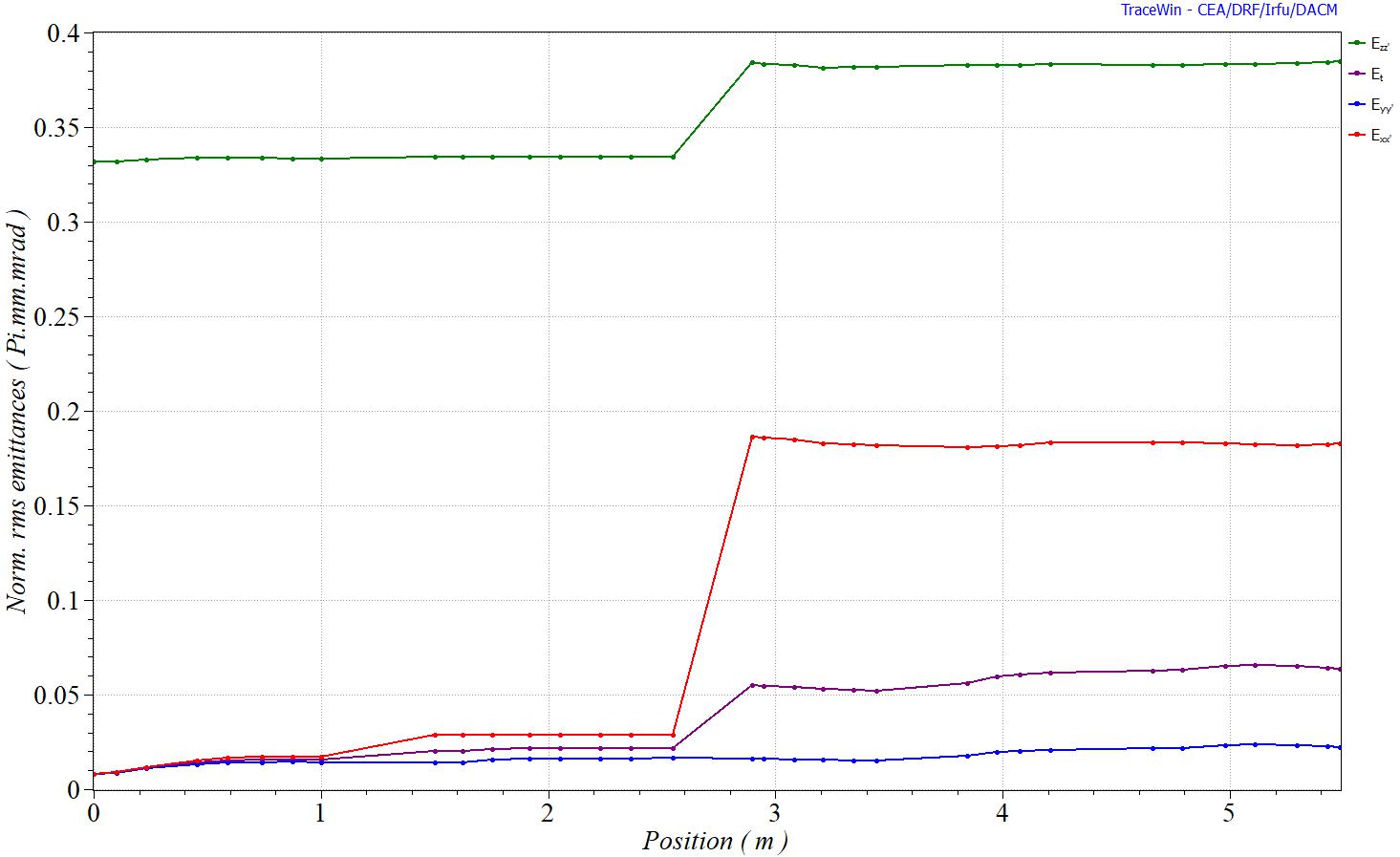

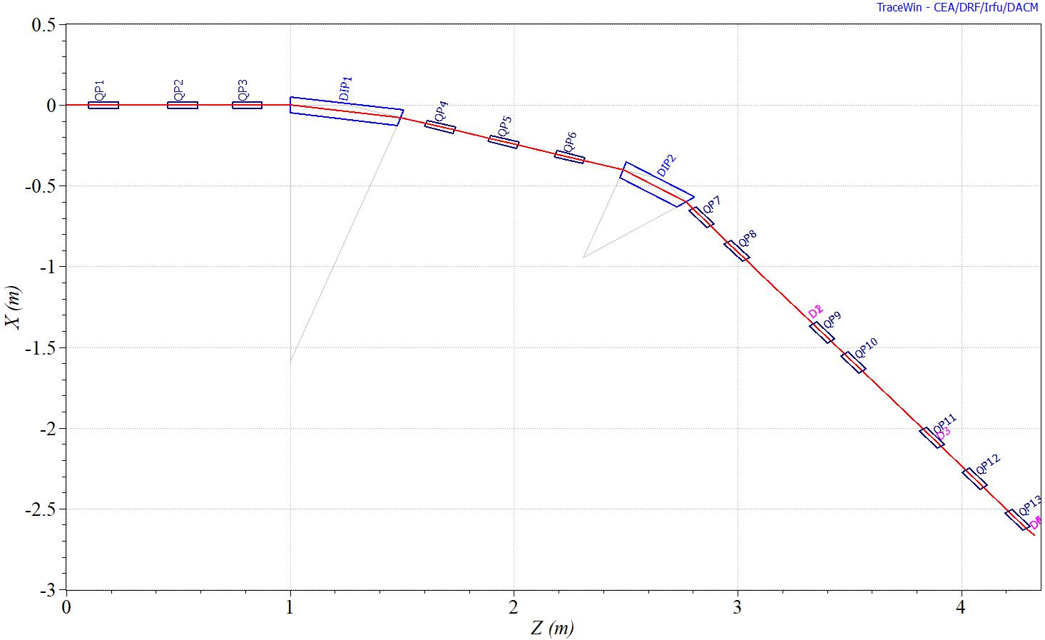

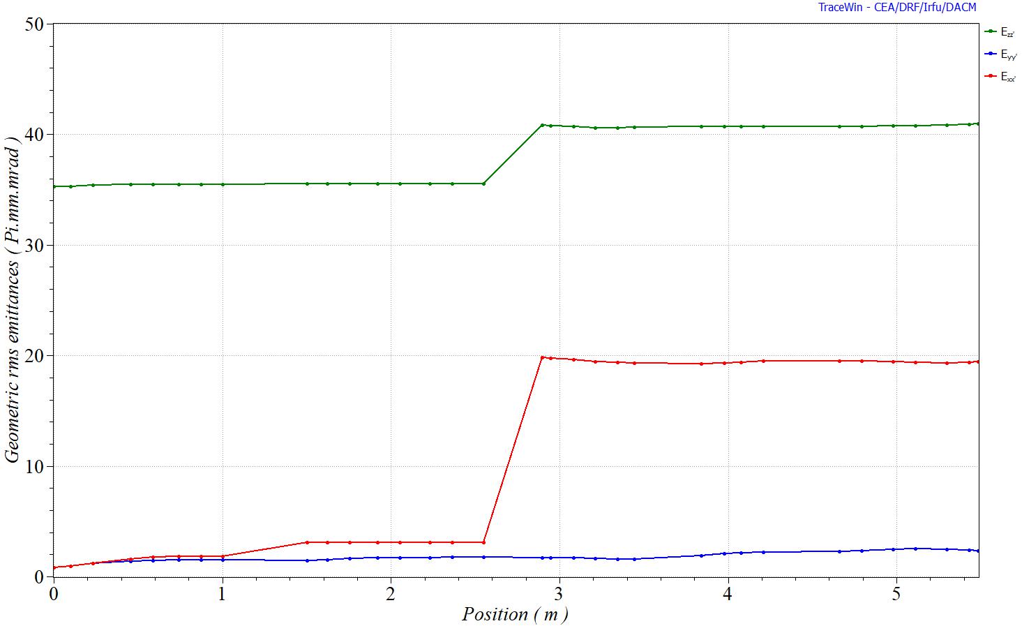

I have same question about emittance growth. In my case there are no any accelerating elements as well as radiation in the line (just Quads and two bends). Yes, I took into account beam charge volume density, but I cannot understand why did 6D emittance significantly (I mean that it is not a result of computation accuracy) increase? I thought that Liouville's theorem for conservative systems must work for this line. Can you explain what is it?
