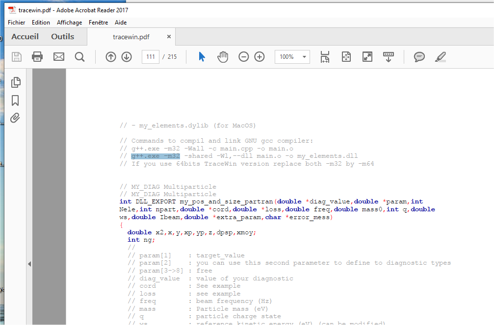

As a first step, I used the example "main.cpp" provided in the manual ().
Here just a small comment for compile command
// g++.exe m32 -Wall -c main.cpp -o main.o (we required to add "-" before "m32", like g++.exe -m32 -Wall )
// g++.exe m32 -shared -Wl,--dll main.o -o my_elements.dll (for the second, in additon to -m32, "--dll" is "-dll")
This is no important but for not expert like me, it saves some minutes.

I read on my manual "-m32", not "m32" ! Where did you find this error ?
And on my side, "-Wl,--dll" works, but anyway, this part can be removed without changing anything.

1)Where did you find this error ?
The error was in my pdf manual.

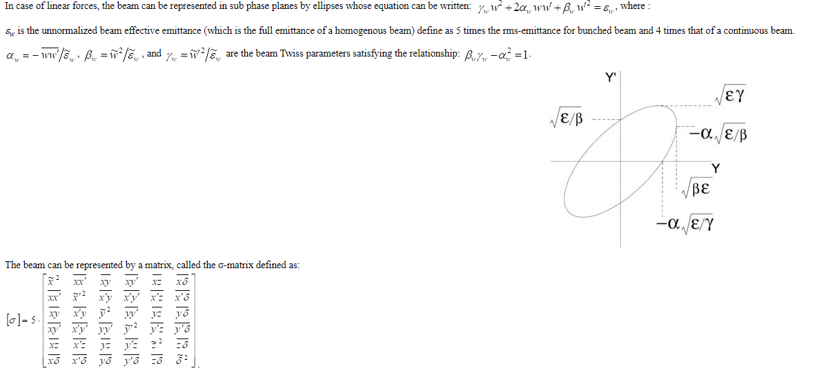

4) Finally, about the Denergy and Dphase diagnostic, I want to know how does the diagnostic call or acces to the so-called "perfect linac energy measurements" or "perfect linac phase measurements".
I asked that because my goal is to develop a DTwissparameters diagnostic, which obtained the delta between "Beam Twissparameter" and the "Perfect linac Twiss parameters measurements".
Thus, I want to understand how it works these two diagnostics (Denergy and Dphase diagnostic) to create the "DTwissparameters diagnostic".

1) here my manual : 2 & 3) You made a confusion about how return the criteria value, please use that instead:

1) About the command in the manual.
I tried to say that you are right, the official version appears "-m32". The error was in my personal pdf manual (for some bizarre reason appeared; however, I already replaced it with a new one and everything is fine.)

I want to compute the Twiss parameters from the Bmat, saved for the perfect linac as a kind of Bcent for the Twiss. And the apply the same as D phase diagnostic.
By that way, Could you tell me how does "DIAG_TWISS" work?
In the end, it is similar to what I want to do; however, in my case, the code itself provides the Twiss parameters.

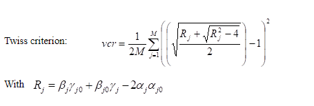

4) Have a look in "Mismatch factor" in manual.

3) Mismatch factor,
I understand for the "DIAG_TWISS" you computed the mismatch factor. I was also thinking about that. Moreover, I want to use the Twiss_criterion in the manual. For that diagnostic element, How do you compute the twiss? I guess that using the following formulas Where the sigma matrix is the Bmat??

3) I don't understand your question. Bmat is indeed the beam matrix and so you can extract the Twiss parameters using the formulas you have noted.
