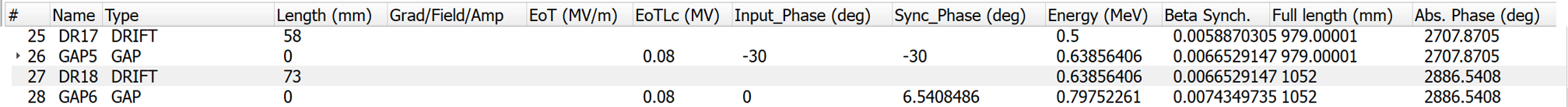

Please see attachment. For GAP6 I used:
GAP 80e3 0 10 3
I expect the Sync_Phase for GAP6 to be
-30 + (2886.54 - 2707.87) = 148.67. I was wrong. It is 6.54. Could you please show me how to calculate the number 6.54?
There is a similar example for DTL Cell on p.51 of the user manual. What sync_phase should one expect to see for each of the DTL cells? Is the example for a 0-mode DTL? How to use Type3 phase setting for pi-mode?
Re: RF phase
It's 2886.54-8*360=6.54°
