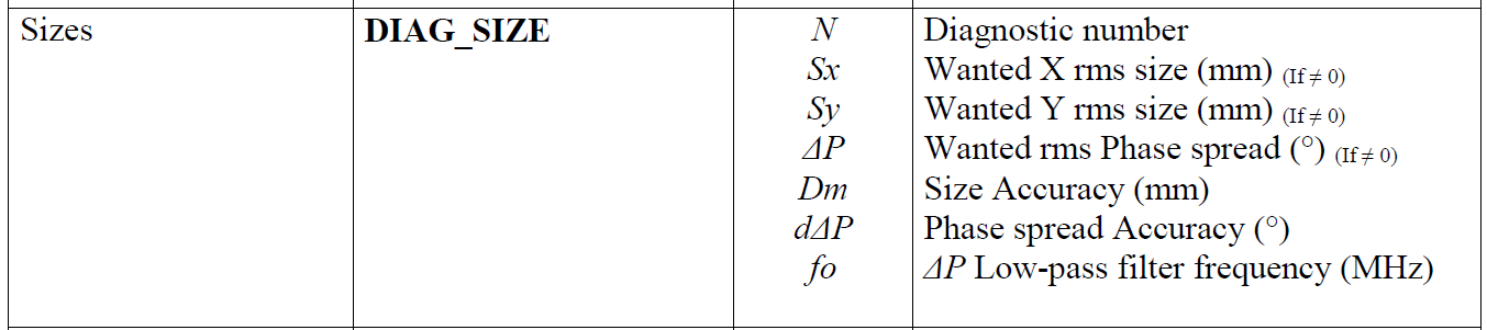

If I understand the user manual correctly, my second example is also for phase spread. Please see attached snapshot.
Screenshot 2021-10-11 122505.png (56.85 KiB) Viewed 6238 times

My understanding to my first example is that:
drift 10 10
diag_dsize3 11 5
drift 10 10
diag_size 11 0 0 20
diag_dsize3 11 5
I am demanding a phase spread dP(z=20)=20 at z=20. At the same time I am demanding the difference in phase spread to be dP(z=20) - dP(z=10) = 5. So equivalently, I am demanding dP(z=10)=15.
The above is exactly the same as my second example:
drift 10 10
diag_size 11 0 0 15
drift 10 10
diag_size 11 0 0 20
My questions are:
Are the two example the same, or if I have misunderstood something?
If they are the same, which one is better to converge the optimization solver?
Thanks and best regards,
