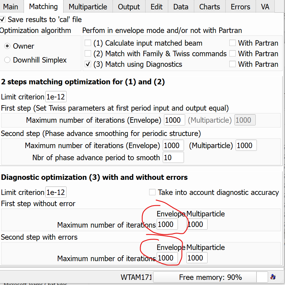

Please see screenshot. Is this what you are referring to?
What I wanted to do is to model a CW beam through an RF gap and optimize certain parameters of the RF gap with Envelope and not Partran. It is because it takes very long time to optimize with Partran. The problem that I run into is that with an initial CW beam, the phase Envelope is not defined, and cannot be used in the optimization.

Yes, this is the right page and again, what you want to do is probably not possible in envelope mode. It's just mathematically impossible. Now doing it in tracking can be fast if you set the right parameters. Maybe if you send me your project I can help you better.
