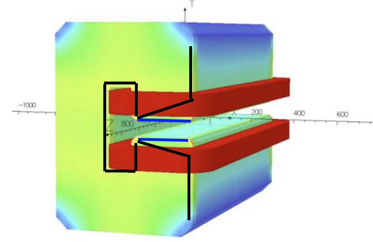

I've look ot the manual and found that field index gradient (FIG), for example, corresponds to the C-shape bend with no parallel poles (black curves rather than blue ones on the figure 1).
figure 1
figure 1
C bend.jpg (38.58 KiB) Viewed 48540 times
In my case I need to somehow simulate dipole-quadrupole like in the figure 2.
figure 2
figure 2
Can MULTIPOLE element hold the members of the B-field decomposition in the series?
Other words is it possible to hold n=1 and n=2 for the MULTIPOLE simultaneously?
Vyacheslav
