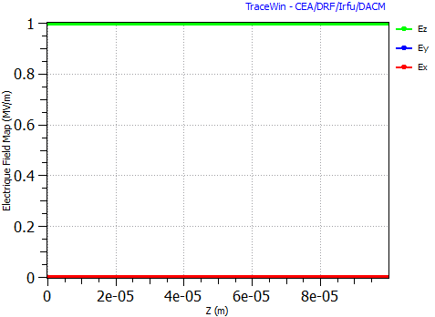

Re: Multi frequency excitation
I'm not sure to undestand your question. Anyway, in all case field_map Tools from "Charts" tab-sheet allows to visualize the field shape used for computation.
For example the Janathan's map:
FIELD_MAP 100 .1 -90 30 1 1 0 0 test

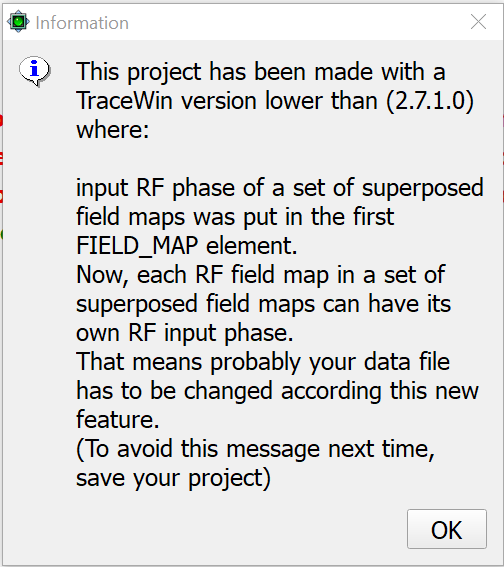

Happy New Year!
While trying the superpose command I received a warning (please see attached screenshot). What am I supposed to do with it?
Thanks.
Happy New Year!
Thanks.
- fieldmap.ini
- (30.88 KiB) Downloaded 591 times
- Screenshot.png (35.32 KiB) Viewed 70723 times
I also wish you a Happy New Year.
Don't worry about this message. If you save your project, it should not reappear.
