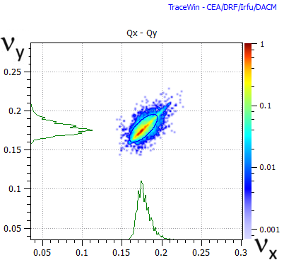

Qxy plot is the tune “Footprints” with Space Charge. This chart is calculated by determining analytically the coherent mode frequencies and plotting them on a spectral chart of single particle frequencies of a well-matched beam.
An example is provided in TraceWin (see "Help" menu -> "Open Examples" and select Qxy_plot.ini project).
In this example phase advance (i=0) is set to 90 deg. Due to tune depression, the average particle phase advance is set to 60 deg, but due to beam distribution type (Gaussian) each particle doesn't have the same phase advance. The frequency analysing allows to estimate that point. The accuracy depends of the number of considered periods (here 2200). The 'footprint' plot Qx,y show these phase advance dispersions. Use the toots Qxy from "Charts" page to visualyse it (see image below)
