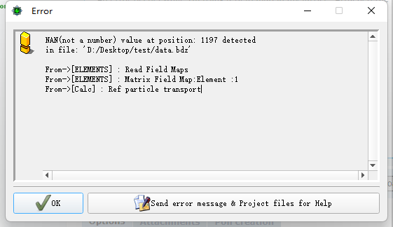

An error occurs while I'm using a field map in my lattice:
Attached the lattice file.

As specified in the message, your file, "data.bdz" contains false numbers, usually marked 'NAN' (Not An Number) and obviously TraceWin is not able to use this type of file.
So check your file to see the problem.
