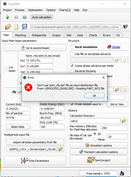

I got this message, see attached.
What is the reason that I can't use "part_rfq.dst" as the input distribution?
It might be related to another problem that I have.

Dear Jonathan,
This specific file name "part_rfq.dst" is used by the code itself in the calculation directory and so your input file would be overwritten. So rename it or move it.
