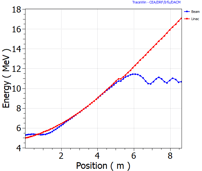

If you open Charts -> Structure Charts -> Energy, there are two curves: Beam and Linac. Does the Linac energy curve represent the energy of the synchronous particle with the designed field strength and phase, assuming no error? Also, what does the Beam energy curve represent?
Re: How to use diag_denergy
Dear Wing-ming,
Yes, most of charts show perfect machine, 'Linac" and th e imparfait machine with errors, "Beam". Exmple below show beam in 2 DTL tank with 4% error about the entrance beam energy. Here, the error is so large that the beam is not even accelerated when it reaches the second DTL tank.
