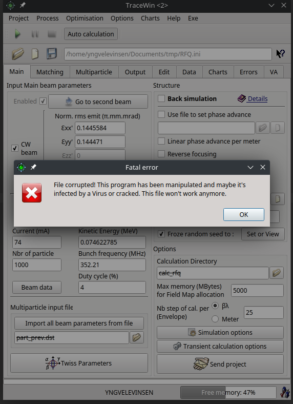

I upgraded from tracewin 2.20.0.5 to 2.20.1.2 today. When I open TraceWin it opens my previously open project. I then after a couple of seconds get an alert that my project file is corrupted. When I click on OK it closes the application.
It's possible that the project file is corrupt somehow (how do I check?), but the behaviour is still problematic because it means effectively it is not possible to open any other project files or do anything with the software since it immediately closes. Deleting the configuration file is a workaround.
Downgrading to 2.20.0.5 works as well.

Re: Corrupted project file
Dear yngve,
It's nothing to do with the project file, but it's the executable that has been modified according to him (Checksum issue).
I've never had this one before and I wasn't expecting it.
Well normally the code should return an error code 3 or 4, are you able to tell me which one ?

Aha, I didn't understand that so well then.
It returns a 4:
% md5sum /opt/tracewin/TraceWin
45baf096f35d3021f01a7d00d2b99fa2  /opt/tracewin/TraceWin
% /opt/tracewin/TraceWin
% echo $?
4

So I figured out what happened with the help of your input. The packaging tool I use on my system (makepkg) "strips symbols from binaries and libraries", which I guess in this case modified the checksum. With previous versions this has not been an issue.
I disabled this option when packaging and now it works. Thanks!
Re: [solved] Corrupted project file
oK indeed my sum :0a65fac494d5da78aba8d0a9ec342c40 for last version on website.
It is true that in the previous versions this verification was more ligth.
I confess I don't understand that you can modify the executables in this way, it seems strange to me, but what does it matter, do you have a solution?
