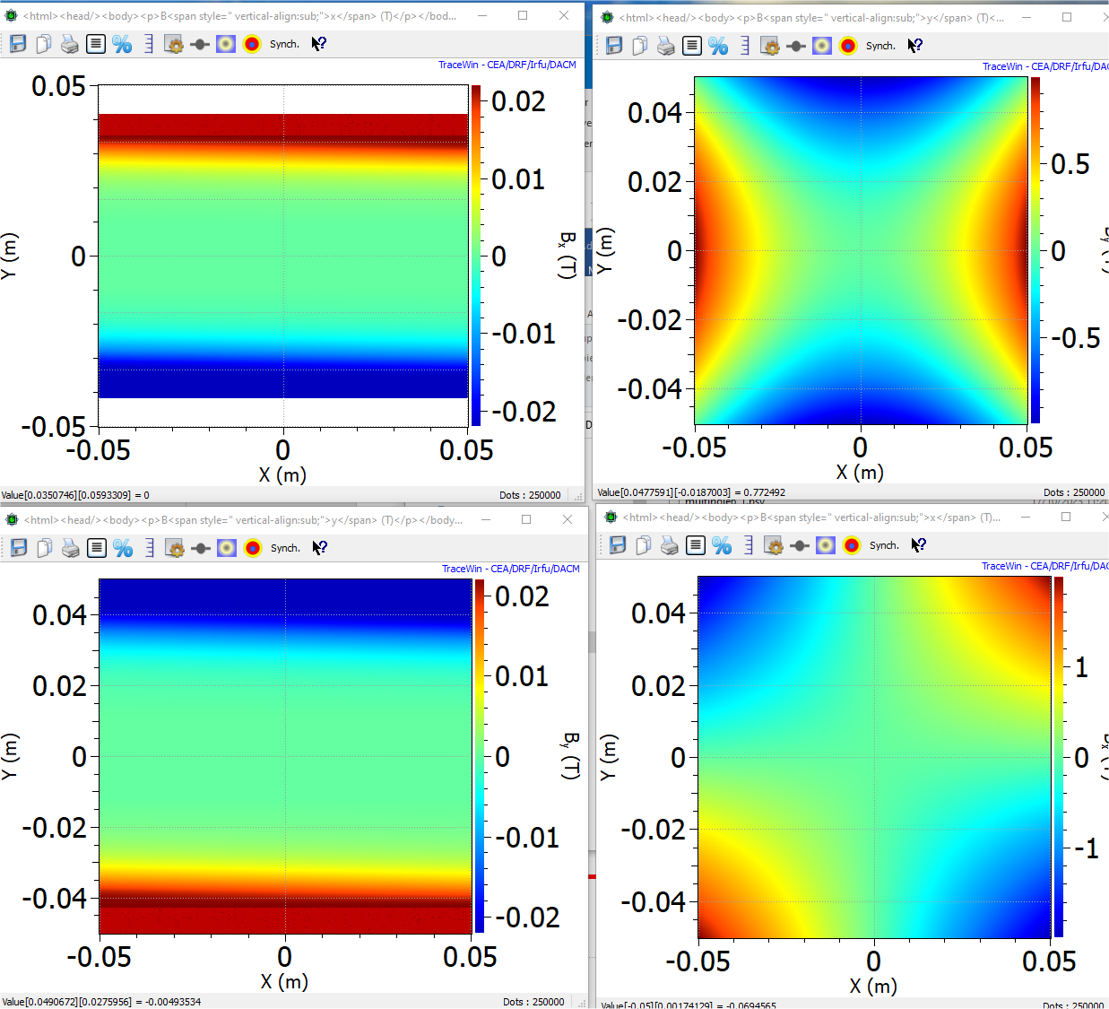

Sorry, I didn't make the previous problem clear. The content of my file with suffix bsx is the same as that of bsy. My main question is about how to match or reverse the X-axis data in the field map with the Y-axis data. I tried to keep it consistent before, but it was not possible, so I would like to ask if there is any way to achieve (currently I can't find this rule), as opposed to the X-axis and Y-axis data generated by multipole iron in the case. thank you

Thanks for your reply,I tried to ninvert the sign of the field before, but I could only change the symmetry of the magnetic field in the Y-axis direction, and could not change the magnetic field direction in the X-axis direction in the case. A data case of multipole iron derivation is attached.

Dear Hanxj,
If it was you who created the SFM2.bsx & SFM2.bsy magnetic cards, here's what you put in them (Left) compared with those of a sextupole (Rigth). I think you can see that this is not the same thing.
