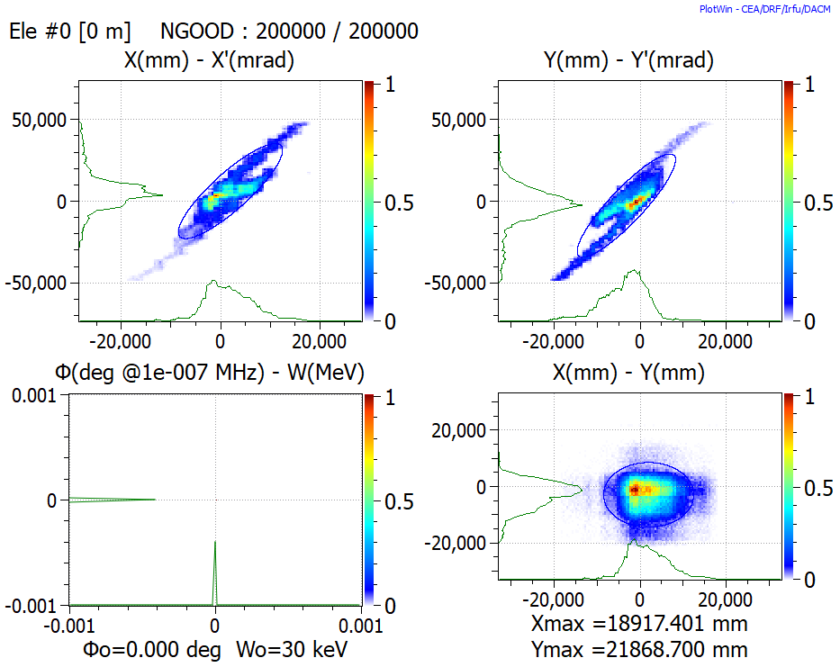

I,ve generated a 4D (x,x',y,y') dst file from emittance measurements with 200k particles, but while I want to run a test, I get the following error messages : Too few particle, From->[PARTRAN]: Find iptsss, From->[PARTRAN] Library...
I run the test with CW tick box clicked.
The test files and distribution are attached.

Dear Emmanuel,
When I open your file with PlotWin I see the following image.
All the values have to be divided by 1000 and the phases would have to be distributed randomly between -180 &+180 °.

My mistake concerning the 1000 divider on amplitudes.
It still doesn't work, with the same error message.
From the vertical and horizontal measurement files, I generate separate txt files with PlotWin, that I merge to get {x,x'} and {y,y'} in the same file. I re-import this file, but which variable use in the fifth and sixth columns ? I tried {z,z'}, {z,phi}, {phi,E} I still don't get a uniform distribution between -180°/+180° as the one I get when I import in PlotWin the measurement data.
