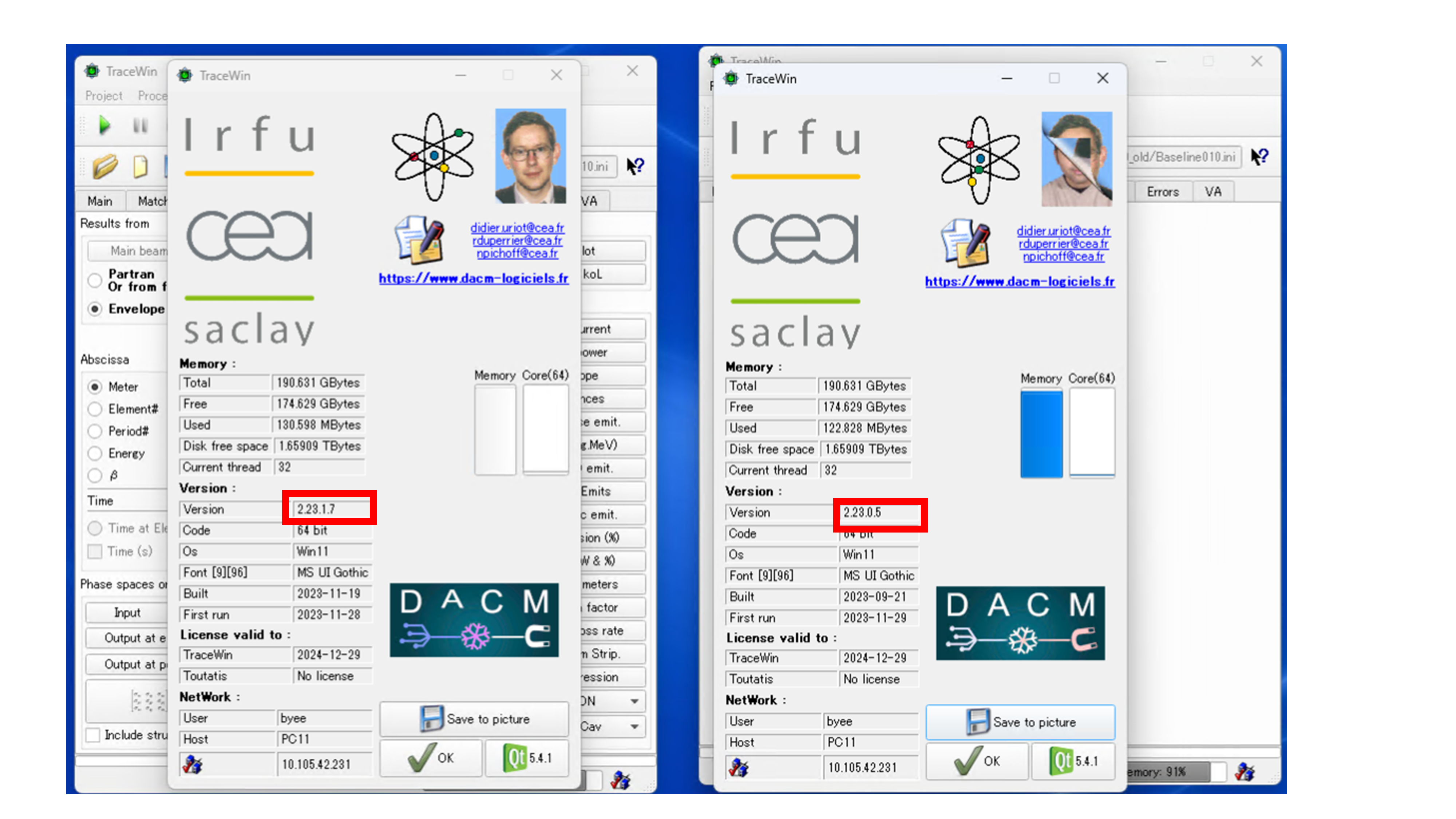

I am having some problems when I make error studies using the new version (2.23.1.7) of TraceWin.

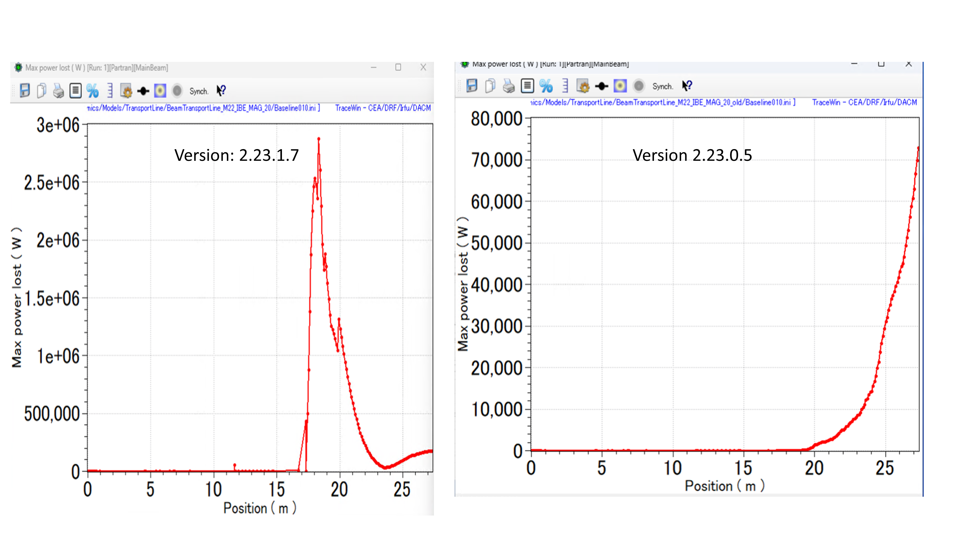

With the new version, I have a considerably large beam loss compared with the previous version of TraceWin.
As an example, I compared the results using 2.23.1.7 and 2.23.0.5 versions.

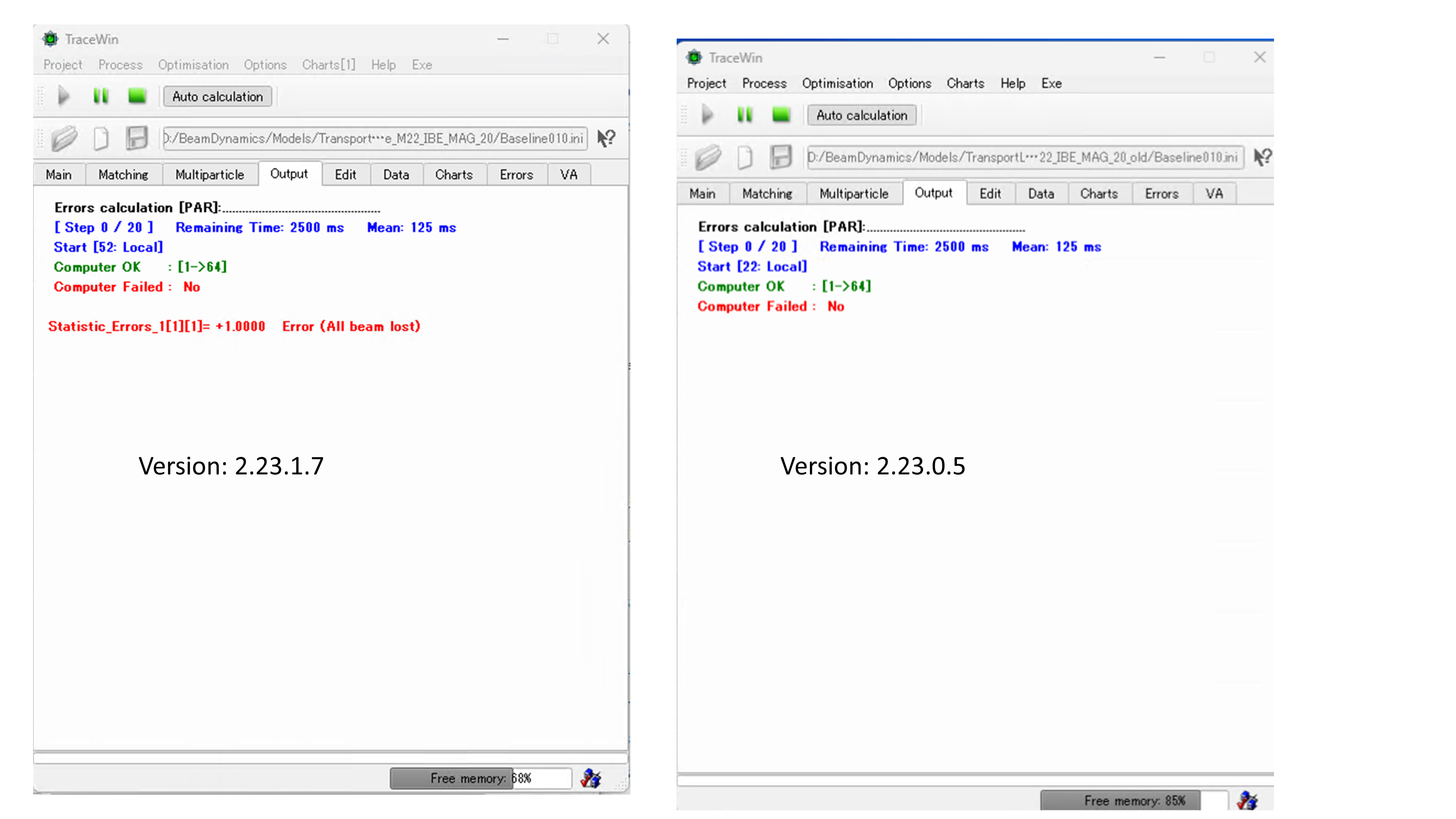

When I ran, I saw a message that I had not seen in the previous version. "Error (All beam lost)"
The results present a large difference in beam losses between the two cases.

I used these two versions to repeat an error study on a known case and compare.
I can't see anything significantly different between the two versions. So, probably your case is very specific and you'd have to send it to me so that I can repeat the comparison with it and understand this difference, which is not, a priori, normal.

Thus, I sent you a simple lattice where the error occurs for version 2.23.1.7, but it seems not for older versions.

Hi Bruce,
I don't know why, but I didn't receive your private message.
Anyway, thanks to your project, I was able to identify the problem with the recent version of TraceWin and fix it. It was a THIN_STEERING adjustment problem.
