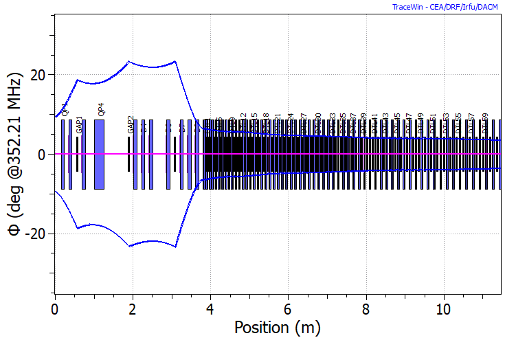

I took a design from the MEBT+DTL of your machine that I had in 2022 and bellow, this is the envelope that I get with the latest version of TraceWin without changing anything in the initial project.
I'm sorry, but I don't know what you're talking about. Please send me a very simplified example illustrating your problem so that I can help you.

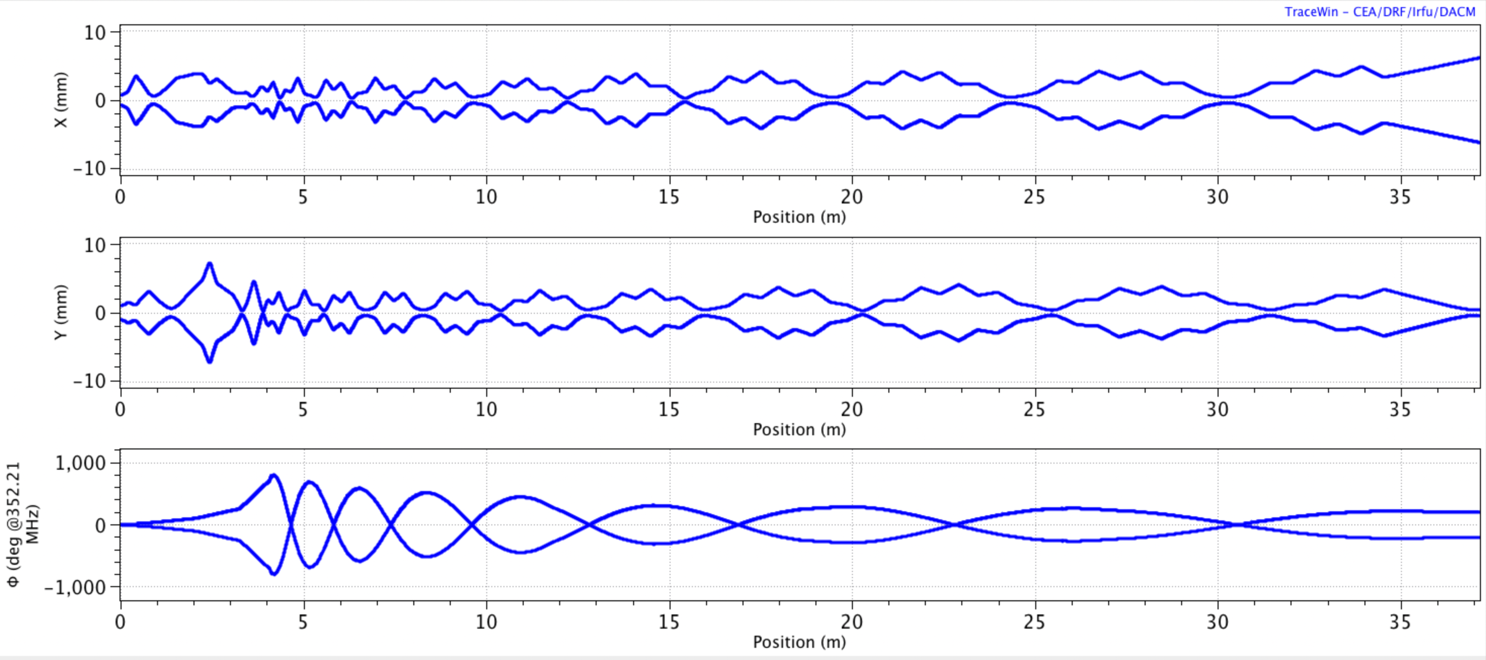

I would get this plot constantly. I even erase everything and started fresh in another folder. This the MEBT+DTL envelopes.

I thought was an issue with the version since the only way I managed to get it working was to roll back to an older one. Maybe there was some setting that got stuck or something with my computer in particular when I did the update, but since in your case it runs fine then it will be hard to tell.

Yes, it's complicated to help you. Having said that, I'm going to focus on the first rebuncher, which obviously works the wrong way round. I'll try to reduce the problem as much as possible and understand where its field value comes from.
