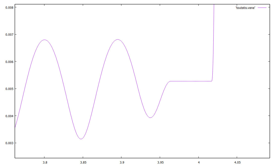

I would like to be sure about the problem you are highlighting. When I run Toutatis with your FromTraceWin.inp, I get the following vane profile at end:
Does it match your expectation? If not, please describe more precisely the gap between your expectation and what is plotted there.

Thinking more about the profile, if you want to produce a trancell not for the cell before the fringe field but the cell before, the code can not generate this because it will only apply trancell rules for the cell before the fringe field. But there is a work around, you can use an externally made .vane. So I suggest to proceed as follow:
1 run the code as you used to get a toutatis.vane with the right length for all the cells
2 modify with another tool (excel or script) the profile at the end to adjust the toutatis.vane => new_toutatis.vane.
3 modify FromTraceWin.inp by using theGeometryFileFlag 1 new_toutatis.vane
4 run the code again, in principle it should work.

Thank you for the quick response! You are right, I would indeed like to apply the "transcell rules" to the cell before the flat section. I only manage to do this if I proceed directly to the fringe field. Your explanation confirms my suspicion that the combination of a transcell and a m=1 section is not possible.
I will have a go at the workaround that you suggest.
Thanks for the support!
