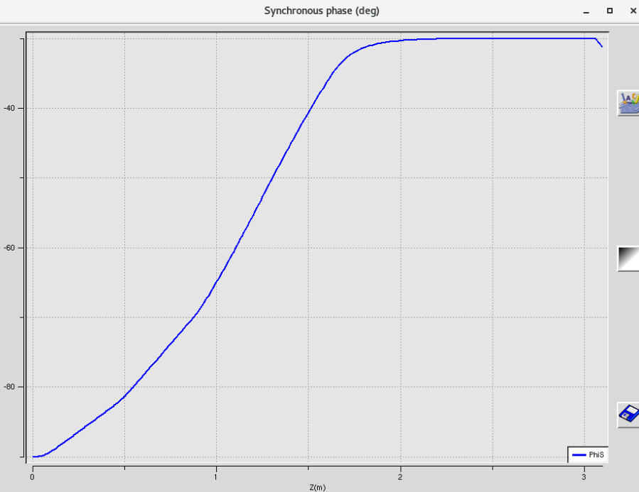

I am designing a 200Mhz RFQ in Toutatis whose cell structure is coming from PARMTEQ PARI.
I observed that there is a discrepancy between Parmteq and Toutatis results especially in longitudinal distribution even though I used the same input cell parameters (Parmteq=0.410 Mev-deg, Toutatis=0.210 Mev-deg). again transverse distribution --> Parmteq = 0.163 mm.mrad, Toutatis-->0.189 mm.mrad

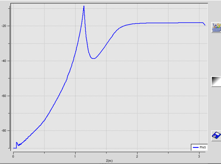

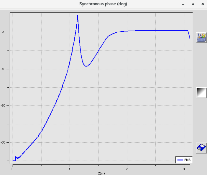

I realized that although the synchronous phase in the input file is from -90 to -30, Toutatis generates a different trend of phase. Please check syncPhase pictures and rfq.dat file.
I would like to transfer geometry from Toutatis to Tracewin. I know that DatFlag comment is the key parameter. Interestingly, Synchronous phase trends change depending on DatFlag comment. Please check phase_with_datflag.png and phase_without_datflag.png. As a result, I could not transfer the data file to Tracewin properly.

I am sorry for the delay in my response but I finally managed to analyse your problem. It seems that you are using a relatively old version of Toutatis. With this version, the code would either read the synchronous phase from your inp file or calculate it by analyzing the cell length. In principle the second method should give similar values but depending on how the cell lengths were set in inp, you could observe discrepancies. Finally, with this old version, it seems that a different behavior is triggered (first or second way to display the sync phase) if you enable or disable the datflag.
I am not capable of being more precise about the behavior of your version because I did not keep the source code for this old version. In general, Didier and I recommend to use the latest version because some bugs could have been fixed. By the way, the last version does not plot the sync phase anymore but just the phase shift between beam center and the sync phase read in inp file.
It is important to note one point: Toutatis is a t-code and does not use the sync phase value in inp at all for simulating the beam in the structure. Only geometrical parameters, voltage and input beam parameters should impact your simulation. When you ask for a dat file for TraceWin, it is the sync phase read in inp file that should be transferred to dat file.
