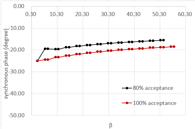

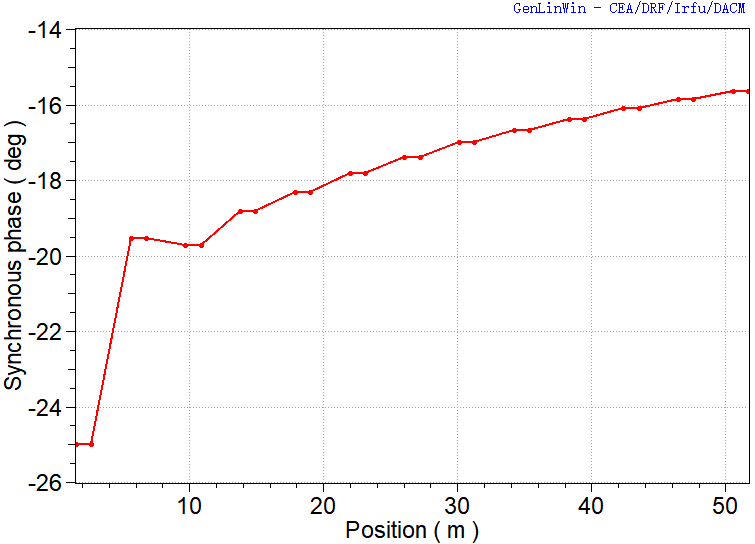

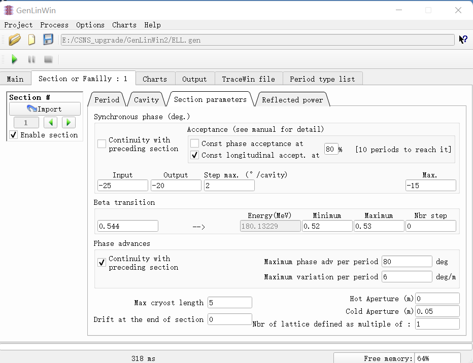

I have a question about using acceptance reduction in GenlinWin.
I set the const longitudinal acceptance at 80%. I think the acceptance will be reduced gradually over 10 periods. However, at the second period, the acceptance is reduced to 80% of the initial one by abruptly improving the synchronous phase. I don't know why. The accelerator consists of 13 periods, and each period contains two spoke cavities.
Thank you
Emily
synchronous phase with 100% acceptance.png (22.47 KiB) Viewed 62395 times
synchronous phase with 80% acceptance.png (14.72 KiB) Viewed 62395 times
Re: acceptance reduction
Dear Emily,
I will look into your problem, but could you put your project file here, which will help me to be sure that I am in your exact setting.
Dear Emily,
Finally I found the problem, it is fixed, please update your code
