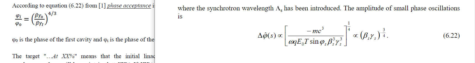

About the equation for the phase acceptance, I think that the exponent is 3/4 instead of 4/3.
According to the reference
Is that correct?
Thanks for your help and support,
Re: Longitudinal phase advance
Phase advance is calculated using the transfer matrix (replace xx' by zz')
For the second point, you're rigth, it's done like this, it's a typo in the manual. I'll fix it.

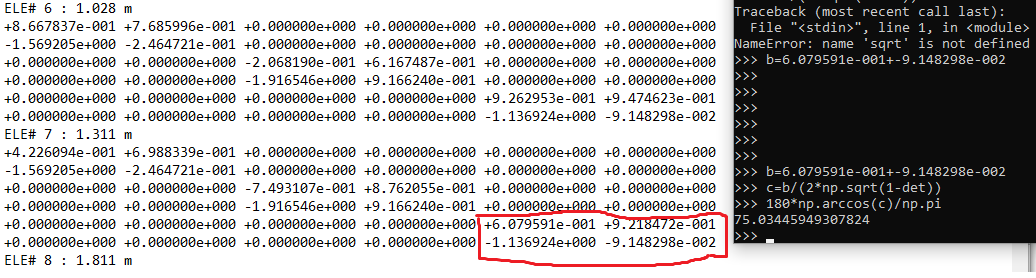

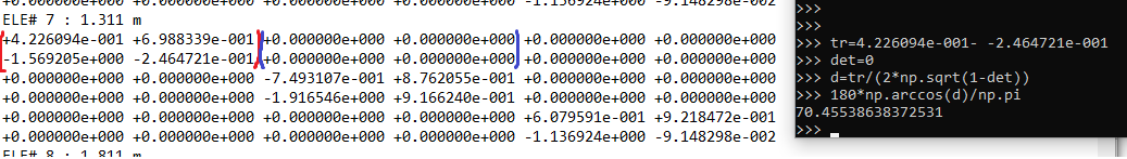

I computed Ko's according to that formula.

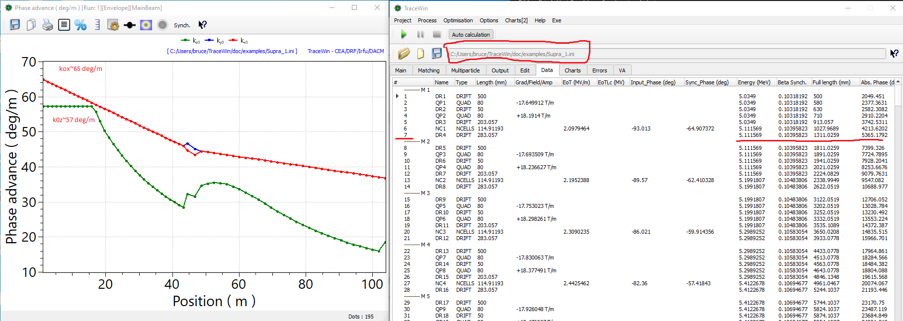

As an example, I tested in the supra_1 example, given in the Example folder of TraceWin.
I used the values of the transfer matrix for element 7 (the last element in the period) to compute K0z.
The variable "det"=0 . The value is different from the 57 deg/m shown in the chart.
Similarly, I computed kox,
In that case, the value is also different from the one shown in the chart.
I already repeated that for my lattice, and the values are also different.
What do you think?

You can find in manual, chaper "Twiss parameters and acceleration" phase advance definition coming from usual beam dynamics cours. In TraceWin it's divided by a parameter allowing to take into accound emittance amortization. But in all case, it's equivalent to the integral of (1/bet) when the beam is matched.
I think in your calcualtion you forget to divid by the length of the period

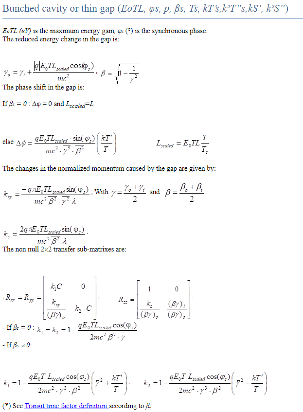

Which is the matrix representation for an RF cavity for a field map in TraceWin?
I found in the Manual the matrix for a bunched cavity. However, I could not find the matrix for an RF cavity for a field map in TraceWin.
Again, thanks for the help and support.
For the field map, there is no specific way to simulate an RF gap or the like. This is a general approach described in the chapter "Particle Motion in the Electromagnetic Field".
