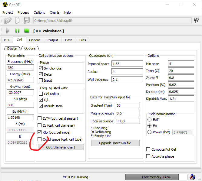

Re: alpha angle as a constant
Dear Seunghyun,
This angle changes according to the size of the quadcopter to be inserted into the cell, so as to reduce the RF consumption of the drift tube as much as possible. So you'd better check it, just uncheck the "Quad space" option on the "Options" page.
I'm not in my office and I can't check this, so let me know if it doesn't work.

I unchecked the 'quad space' option, however the nose angle alpha was changing.
In the manual, it said that 'Kilp' allows to limit the max field by adjustment of the angle of the cell nose.
So I unchecked that too. But the angle was still changing.

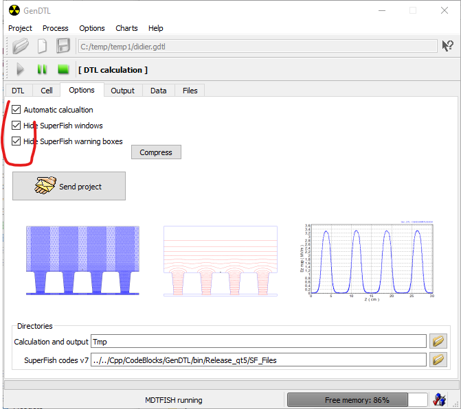

Dear Seunghyun,
I removed the "quad space" option as suggested earlier and that worked, the alpha no longer changed.
Here are some other options I would suggest
