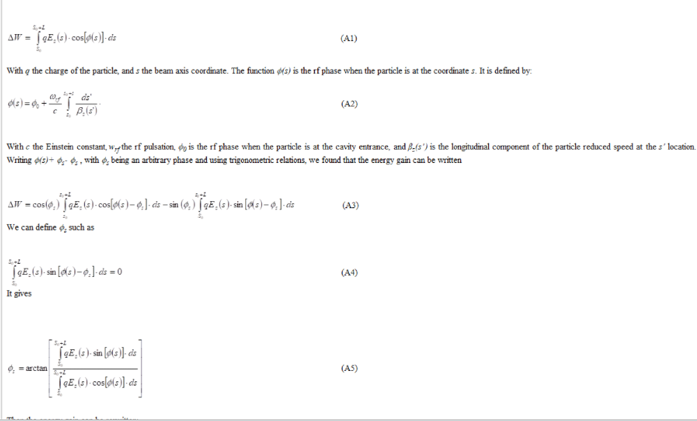

From the previous definition:

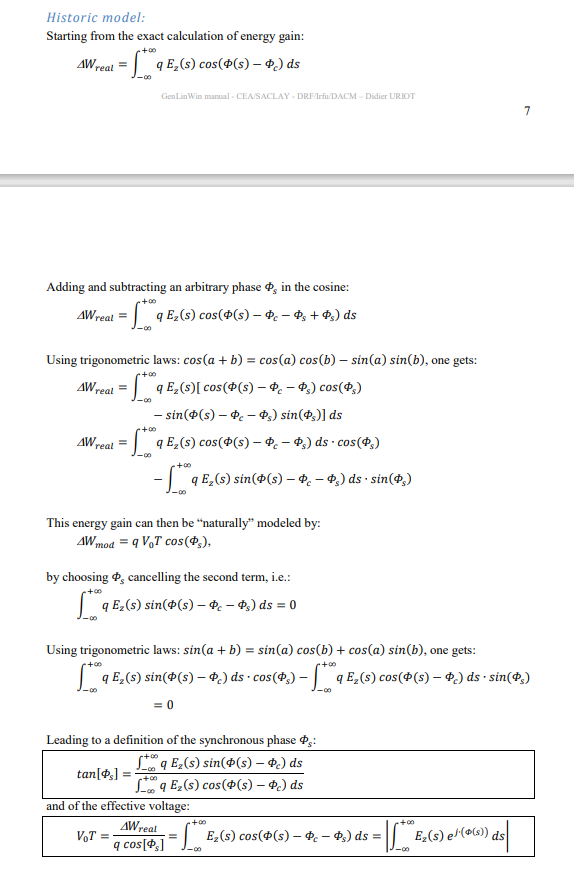

With the present one:
I have the next questions:
1) Is Eq.(A.2) remain the same in the updated definition?
2) How is defined the PHI_C (RF phase in the cavity)? (Maybe this is related to the 1 question).

Re: Update definition of the cavity phase parameters
Post by Francenpichoff »
2) With this new notation, PhiC models the RF phase in the cavity ( PhiC changes by by 1° when the RF field is changes by 1°).
As you can see, by arbitrary definition, -PhiC is the RF phase when Phi(s) = 0 (or the RF phase is 0 when Phi(s)=PhiC).
In the former definition, "Phi(s)" was the RF seen by the particle when at s.
Now, "Phi(s) - PhiC" is the RF seen by the particle when at s.
1) YES, equation (A2) remains the same, considering the phase of the RF field seen by the particle.
With the new notation, this field is written "Phi(s) - PhiC".
Whatever the way the synchronous phase is defined (with or without PhiC), the particle dynamics is always calculated withthe RF field seen by the particle.
Best regards.
Nicolas.

Dear Nicolas,
Thank you very much for your explanation.
In summary,
Phi(s) -PhiC = Phi0 + (wrf/c )x int(ds'/Betaz(s')). (AA.2)
1) The updated version of Eq. A.2, right?
Let's called this last equation (AA.2).
From the previous discussion ( viewtopic.php?f=3&t=55)
2) Phi0 is the RF input field phase, right?
3) How that GenLinWin computed Phi0?
Usually, give Phi0 you compute Phi(s) and then Phis (synchronous phase) is computed using Eq. (A5) in the former notation.
However, as the manual says the Phis is "selected" to satisfy Eq (A4), then automatically satisfy Eq. (A5).
My guess is that given Phis, you can obtain Phi(s) and the Phi0 right?
Thanks for your help and support.
1) Yes. (AA.2) is equivalent to (A.2) with : Phi0 (Phi0_new = Phi0_old - PhiC)
(A.2) --> Phi_old(s) = Phi0_old + (wrf/c )x int(ds'/Betaz(s'),s0,s0+L).
--> Phi_old(s)-PhiC = (Phi0_old-PhiC) + (wrf/c )x int(ds'/Betaz(s')).
--> Phi_new(s) = Phi0_new + (wrf/c )x int(ds'/Betaz(s'),s0,s0+L) (AA-2)
2) In that case,
Before : Phi0_old was the value of Phi_old(s) when s = s0 (when the particle enter the field map)
Phi_old(s) being the RF phase.
Now : Phi0_new is the value of Phi_new(s) when s = s0 (when the particle enter the field map)
Phi_new(s)-PhiC being the RF phase.
3) I let Didier answering to this question (dealing with the way it is implemented).
Conclusion :
I realised, with your pertinent question, how much confusing can be our change of notation.
I incist, the physics is still the same, only the physical meaning of the variables (with same name !) have been changed, which is, I confess, much confusing.
We will examin with Didier what we can do to be clean this "natural" confusion and will let you know.
Thank-you for all.
Best regards.
Nicolas.
