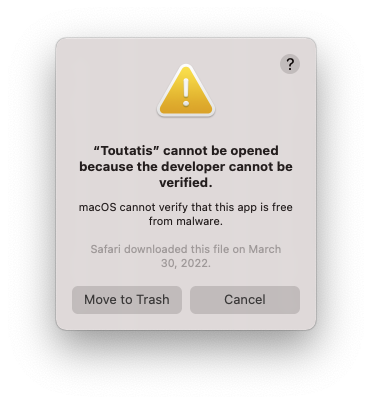

I get a pop-up that says “Toutatis cannot be opened because the developer cannot be identified” and it will not run.
Screen Shot 2022-06-03 at 6.06.22 PM.png (62.99 KiB) Viewed 19574 times

For historical reasons, GUI version of Toutatis and most console versions are 32 bits. So your platform has to be capable of running such 32 bits apps. We just added a 64 bits console version for you in the .dmg. But 64 bits GUI version are not planned for a close futur even we are working on it.
Based on the screen shots you shared (by the way, they are very useful), I see that you also have anti virus issue as you got the message that the numbers of users is too low. This, we can not do so much about it and it should be tuned at the host level.
