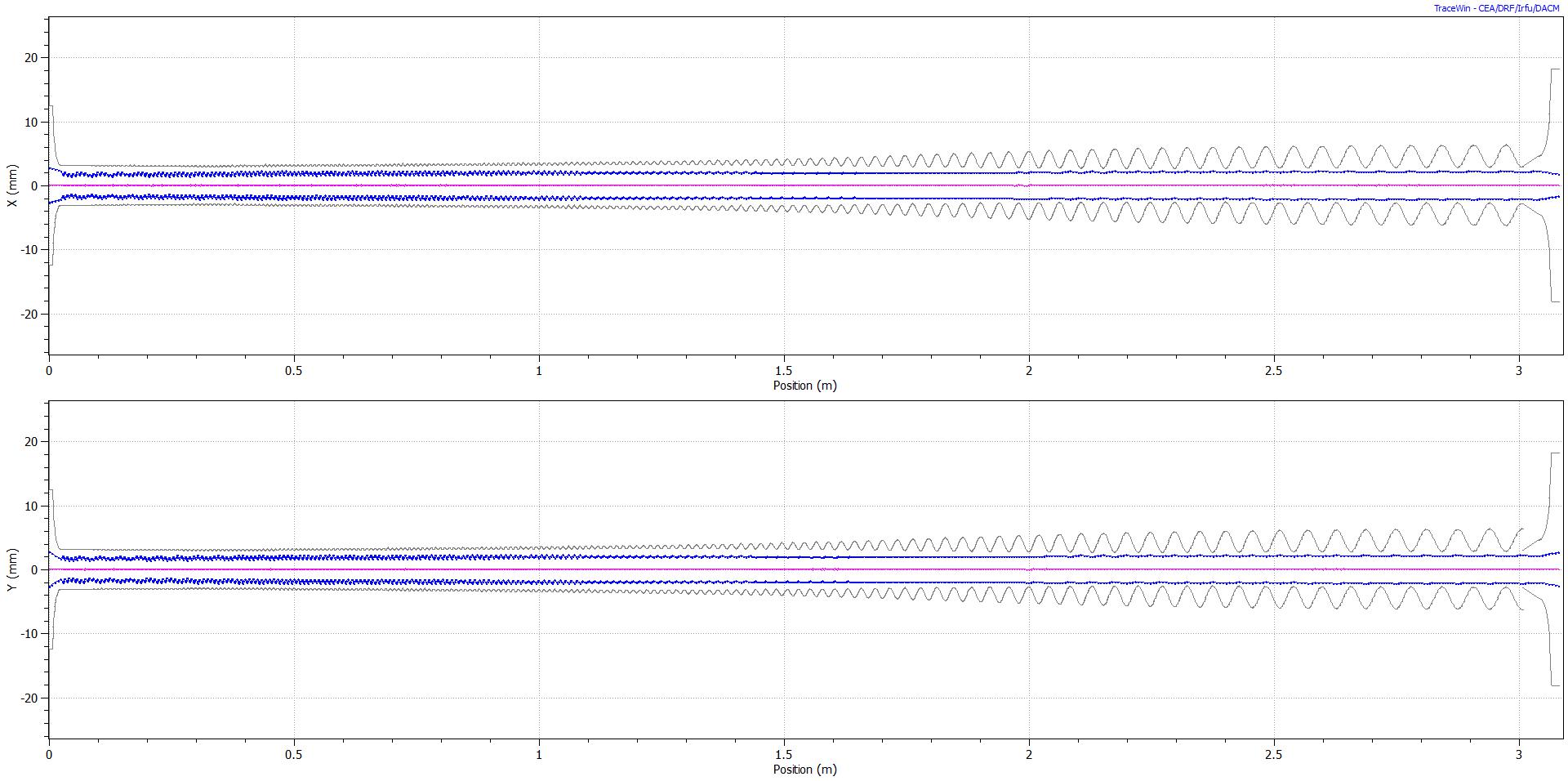

This is beam envelope plot which I have generated from RFQdesign to TOUTATIS and then Toutatis to TRACEWIN automatically. Still it has break in Y profile near end of RFQ. Please suggest how to join this profile.
Thanks
Sarvesh
Break in Y vane profile

Dear Sarvesh,
Ok, I'll improve vertical plot of RFQ vane in next version, but clearly, this chart doesn't show the real geometry of vanes, it's only a rough illustration, especially for the end cells, that doesn't represent the reality of what you will find in the *.vane file (see RFQ tool from Chart page).

Thanks URIOT, Please suggest where to see total RF power of RFQ, Cavity power plot is not the same as total power? Total power= Peak power + Beam Power. It should be of the order of 300-400 kW for 3 MeV, 3m design Proton RFQ. But I am not able to find it anywhere in TRACEWIN and Toutatis.

Dear Sarvesh,
TraceWin is not an electrostatic code and is obviously not able to estimate the RF power in a copper structure.
Maybe you could ask this question in the RFQ_Designer forum. The RFQ experts here might be able to suggest solutions.
