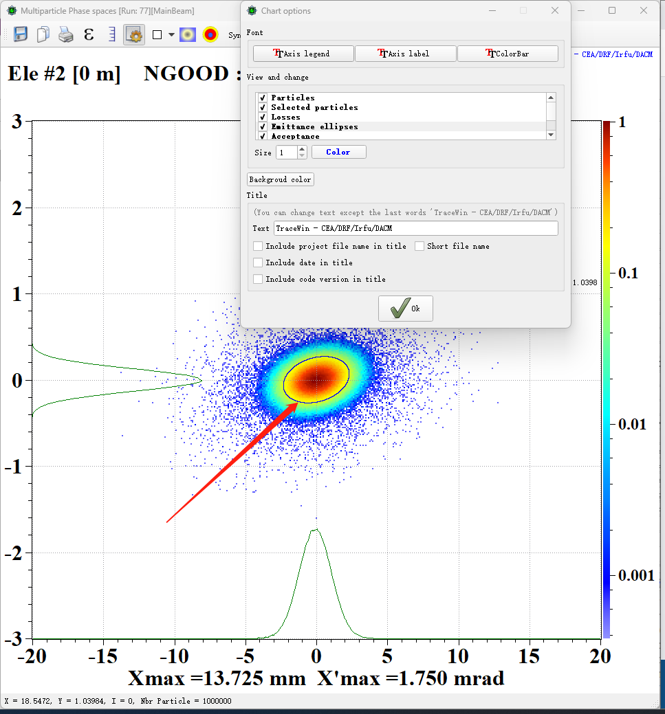

Re: "select particles" function improvement
Didier,
Thank you!
About the ellipse selection, how about cutting it according to the edge defined in "Charts - Output - Options - Emittance ellipses"?
Kinds,
shliu
Yes, very good idea and much easier to implement.
Added in the last release.

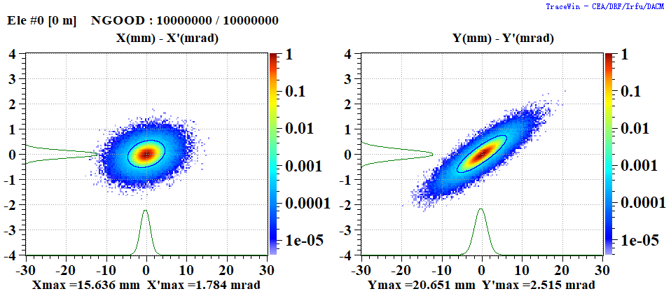

The initial distribution:

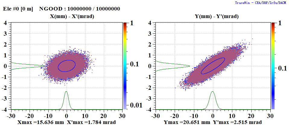

Select particles in xx' plane:

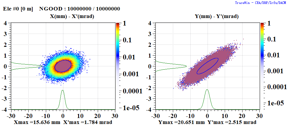

Then select particles in yyp' plane:
The selected particles are in xx' ellipse OR yy' ellipse. How to select particles in xx' ellipse AND yy' ellipse at the same time?
Dear Shliu,
First select particles in the XX' chart, then in the TYY' chart to have both in the same time!
That is the way I did in the last post. Could you please check it?
If I choose it in xx' and yy', some particles outside of the ellipse in xx' but inside the ellipse in yy' would be chosen, which is not my purpose.
Dear Shlui,
Sorry, I didn't see the "AND".
Ok, it's done in the last release
