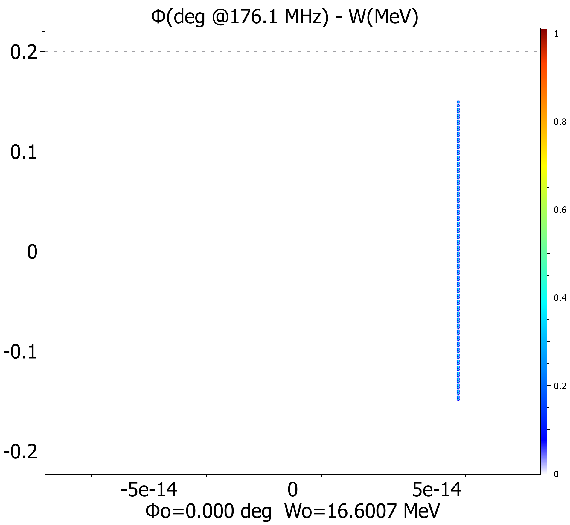

2/ I'm creating a .dst file with 100 particles (protons) which are all started on axis (x=x'=y=y'=0) and have only an energy spread (phi = 0). The file seems to be read correctly in TRACEWIN (see
). But when running TRACEWIN with this file, I get 'Particle with negative energy' ... The Twiss parameters are obviously not calculated from this simple input distribution, but are the actual correct Twiss parameters for this linac. The purpose here is to launch just a few 100 protons to verify the longitudinal beam dynamics and acceptance.

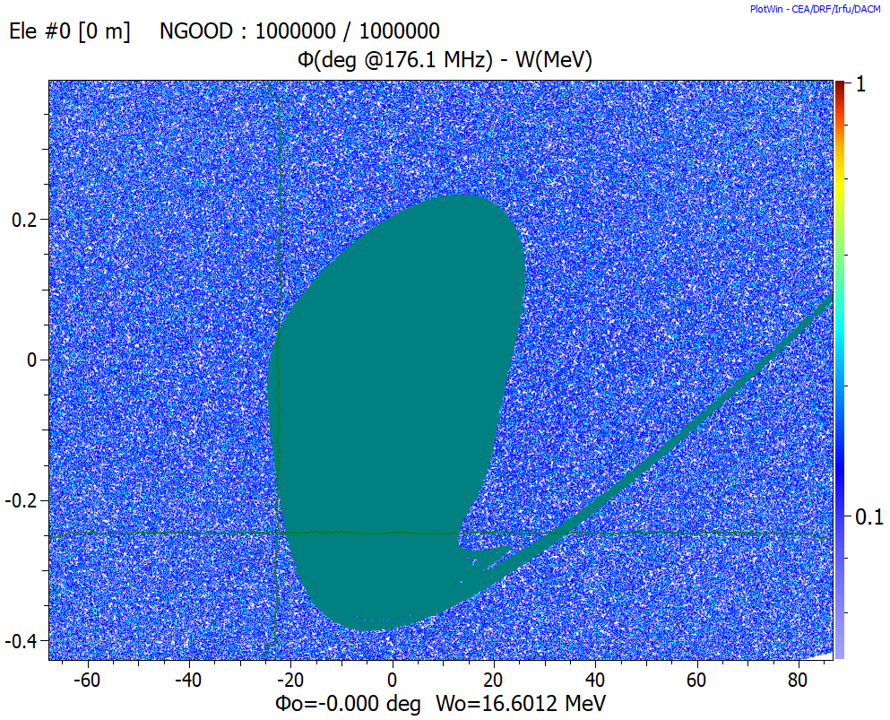

Re: Reading and creating .dst files
Dear Jarno,
Ok it's fixed in the last version.
But you have to understand that set a beam current with such a distribution was necessarily going to cause problems in the space-charge calculation, hence the crash you had.
That said, you won't be able to calculate an acceptance with your method. I strongly suggest that you use the method I've given you in the manual (I've upgraded it a bit to take account of your rather specific case). For your information, I've made the calculation and below is the image of the longitudinal acceptance of your machine.
