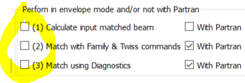

The 2nd request is about the checkboxes I highlighted in the attachement ...
be
so something like
./tracewin_noGUI.exe .... match_flag=0 match_partran=Y
where match_flag= 0,1,2,3 refers to the kind of matching one wants to do and 0 is no matching ...
Hope this clarifies the request ?
With kind regards
Jarno
Re: Choose optimization algorithm in _noGUI
Dear Jarno,
Ok 3 new arguments have been added: "alog=0/1/2", "cancel_matching" & "cancel_matchingP" (see manual for detail)
https://dacm-codes.fr/Softwares/TraceWi ... .htm#BATCH
