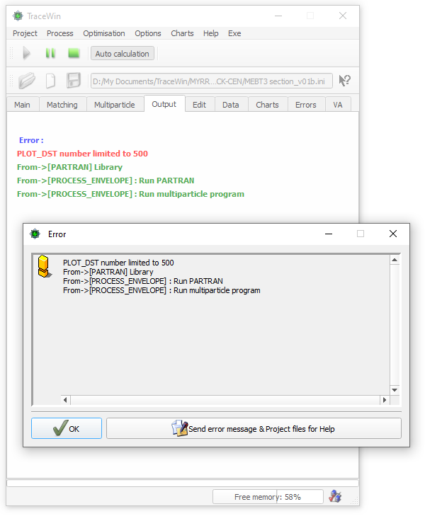

Lately I get this error message sometimes during PARTRAN optimizations.
PLOT_DST number limited to 500
From->[PARTRAN] Library
From->[PROCESS_ENVELOPE] : Run PARTRAN
From->[PROCESS_ENVELOPE] : Run multiparticle program
It happens only sometimes and I cannot find the reason.

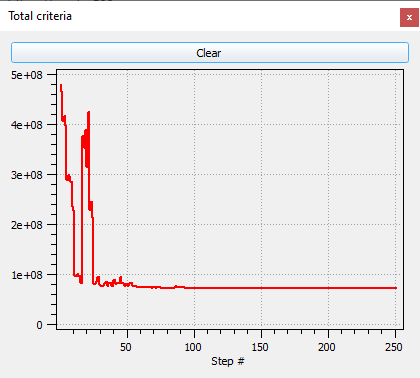

Once it has happened, I cannot continue with the optimization until I restart TraceWin.
It happened at step #250 although the limit of iterations was set to 500 for multiparticle in the 'Matching' tab.

Re: PLOT_DST limit error
Dear Emo,
I think I've found the problem, but I'm not sure because I don't know exactly what you are doing. Before I put a new corrected version online, I would like to see your project if it is possible for you. Could you post your project files, *.dat and *.ini
Dear Emo,
Thank for your project files.
Ok, problem is now fixed in the new TraceWin version available. So please upgrade your code.
