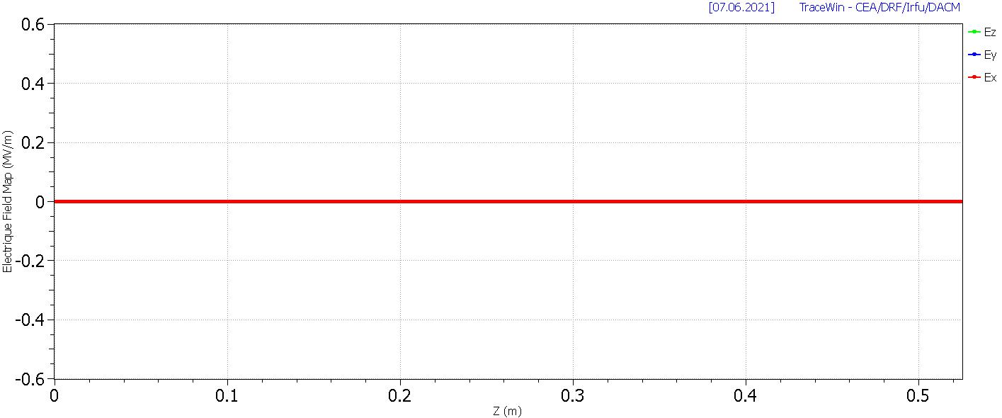

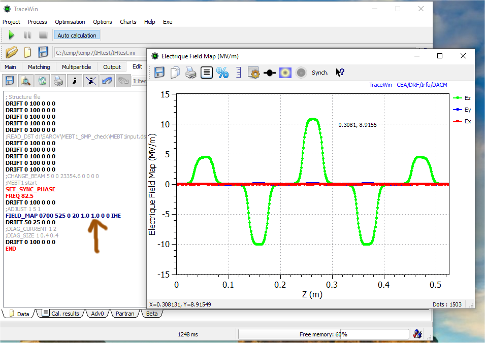

why is zero electric RF field on field map viewer? Data in the field files are in MV/m.
On more addition about notation on the plot: Electrique->Electric.
TEST.rar- (5.64 MiB) Downloaded 337 times
Re: Field map implementation
Dear Vyacheslav,
It's because you set 'ke' parameter to '0'
And thank you, I have corrected the spelling error you noted (next version)

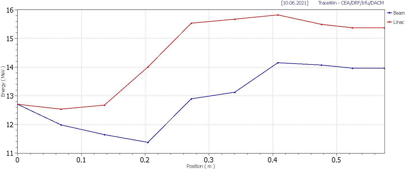

why does Linac Energy differ from Beam one? What does Linac Energy mean? Is it energy of the synchronous particle?
Is the beam energy is the mean value on the all particle energies?
How can I change synchronous particle phase? Just using SET_SYNC_PHASE before FIELD_MAP and put the third parameter equals to the desired synchronous particle phase or by means of SET_BEAM_E0_P0?
Dear Vyacheslav,
Linac: corresponds to perfect particle transpor in perfect linac
Beam : is real beam including average beam centroid and linac errors
So, your plot, it's envelop result of a beam where you set an phase centroid errors, it's why beam curve is not simillar to "linac" one
To change synchronous phase the first way is to change by hand the RF phase or lets code do it itseft, using SET_SYNC_PHASE
And your last question: perform 2 runs with or without matching options.
