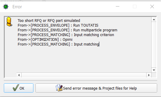

in the attached tracewin project, a long RFQ, is not working the option to calculate the input matched beam with Partran.

Dear Michele,

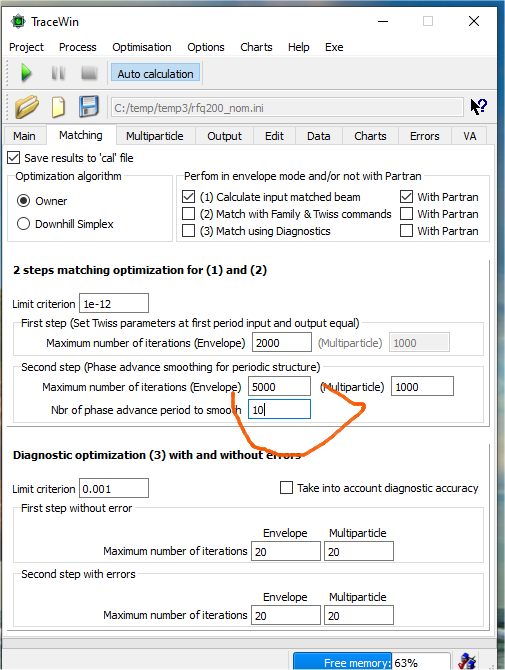

Toutatis is not able to simulate too short RFQ, it's why matching of RFQ imposes to define a number of lattice greater than 6 for simulation, like following picture

with the phase advance put to 10 now works!
