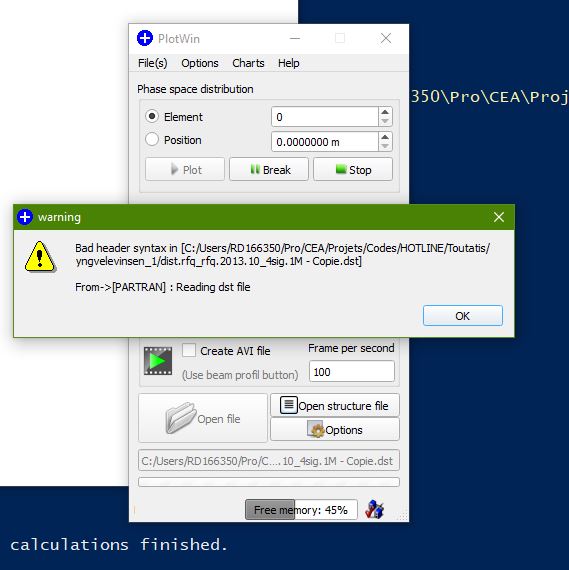

I have no problem running the code with your input files but the .dst. At the moment I use your .dst file, the code freezes. When I try to open your .dst with Plotwin, I get the error message in the attached picture. Please consider revising your dst file and check it before runing Toutatis with PlotWin.

while I was debugging your case, I just realized reading your dst file with Plotwin that you inject a 3.6 MeV beam into a RFQ made for 75 keV. I guess you are trying to use the wrong file as input.
