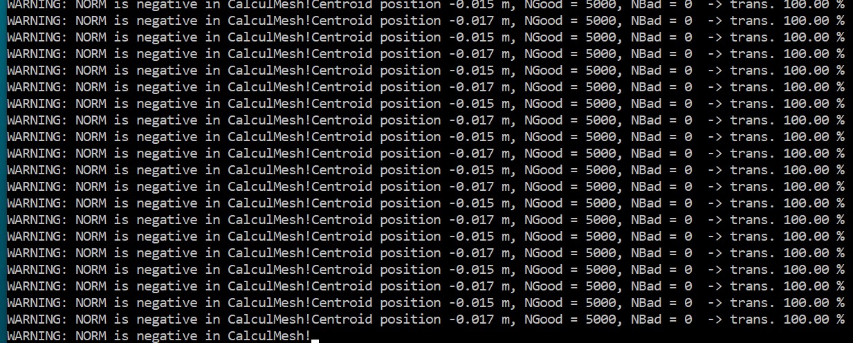

more over, with the Fixed files I have problems also with this project (see attachment).
Fig.
Fig.
Error 3.jpg (327.62 KiB) Viewed 27111 times
Regards, Vyacheslav

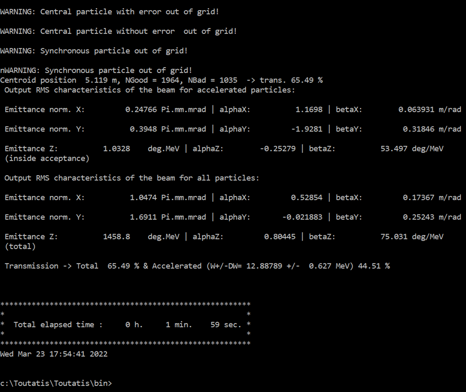

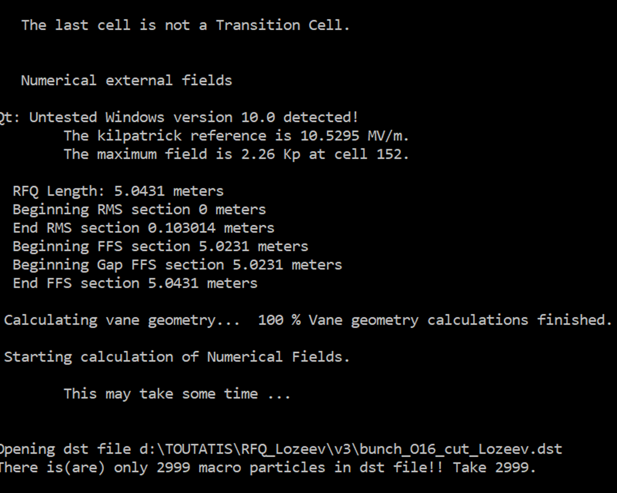

unfortunately, with the use of the last fixed files of the program, that was shared by you, a message below appeared for the attached project.
Fig. 1
Fig. 1
Under the original file it calculates dynamics whatever it is not perfect.
Fig. 2
Fig. 2
Is it correct?
Vyacheslav

based on the output, I see that you are using the older version. With the new version, results on my platform are however similar:
Centroid position 5.114 m, NGood = 1961, NBad = 1038 -> trans. 65.39 %
Centroid position 5.123 m, NGood = 1961, NBad = 1038 -> trans. 65.39 %
Output RMS characteristics of the beam for accelerated particles:
Emittance norm. X: 0.24036 Pi.mm.mrad | alphaX: 0.56472 | betaX: 0.091409 m/rad
Emittance norm. Y: 0.42663 Pi.mm.mrad | alphaY: -2.8881 | betaY: 0.31189 m/rad
Emittance Z: 0.97941 deg.MeV | alphaZ: 0.19511 | betaZ: 57.713 deg/MeV
(inside DW_FILTER = 0.5 MeV)
Output RMS characteristics of the beam for all particles:
Emittance norm. X: 1.7639 Pi.mm.mrad | alphaX: 0.90201 | betaX: 0.098242 m/rad
Emittance norm. Y: 3.5977 Pi.mm.mrad | alphaY: 0.21614 | betaY: 0.079765 m/rad
Emittance Z: 326.7 deg.MeV | alphaZ: 0.032046 | betaZ: 10.265 deg/MeV
(total)
Transmission -> Total 65.39 % (W = 9.01046 MeV) & Accelerated (W+/-DW= 12.85646 +/- 0.500 MeV) 44.61 %
I have not seen anything wrong in the simulation and the results seem consistent with design parameters.

the problem is that with the use last updated version of the file, shared by you, on my PC the calculation stopped on the FIG.1 from my previous message, namely, on the string "There are only 2999 ..." and no other actions were taken.
What can it be?
Vyacheslav

I ran your case with my current version that shoulf be as recent as yours. It worked. Anyhow, I will retry by Monday to run your case. If it works, I will send you the executable I used and then let me know what happened.
