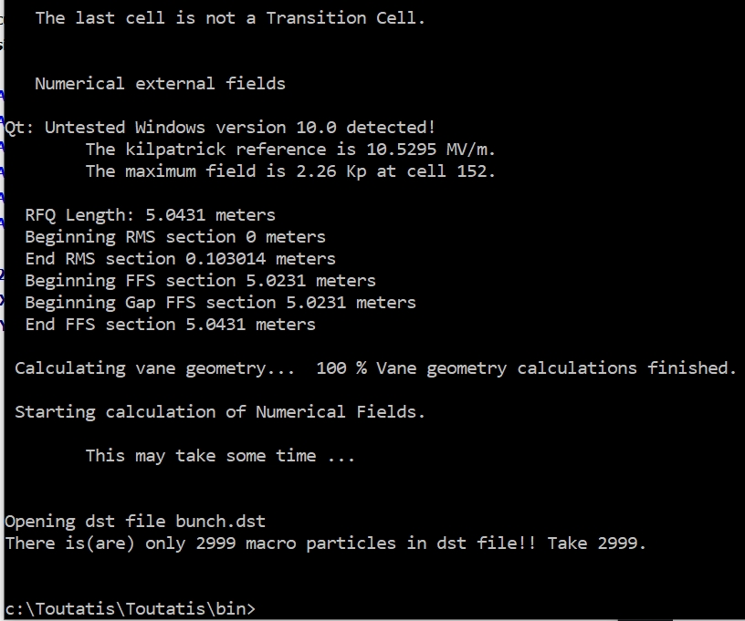

Dear Romuald,
the results obtained for the files shared are in the attachment.
There are massages in the command prompt:
The program did not perform particle tracking.
Vyacheslav.

the messages in the console do not say anything abnormal and unfortunately they do not help solving the problem.
I noticed something wrong in your vane file as a last line is missing for finishing the pole. Also, I do not understand why it runs on my platform and not on yours. Please re try with the attached vane file instead.

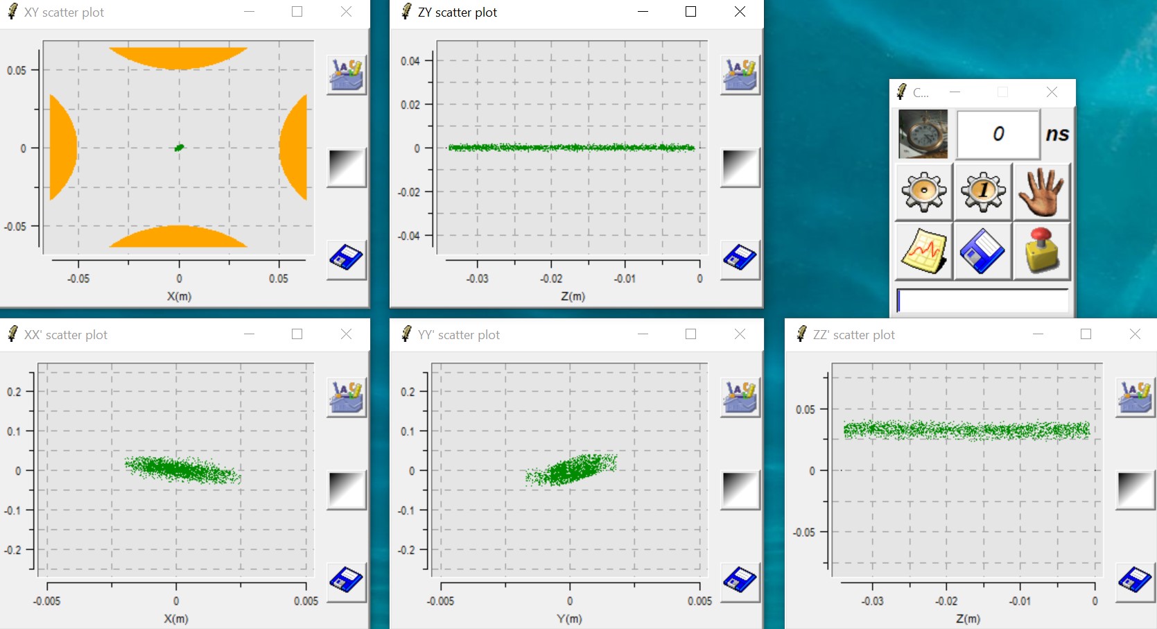

Dear,
unfortunately I did not see any changes.
Moreover under your updated Toutatis.exe file, after running the program via command prompt, the windows are on the figure below did not appear.
Why?
Vyacheslav.

Post by FranceRomualdDuperrier »
As we are using the same files (exe and inputs) and do not get the same results, the source of the problem should be the environment. Your case runs on my platform with or without graphics. So I need you to test with different machines or disk locations or whatever you may think as relevant.
Please try this and if it does not ring any bell, I can try to compile a version that is very verbose to see where exatly the program stops.
