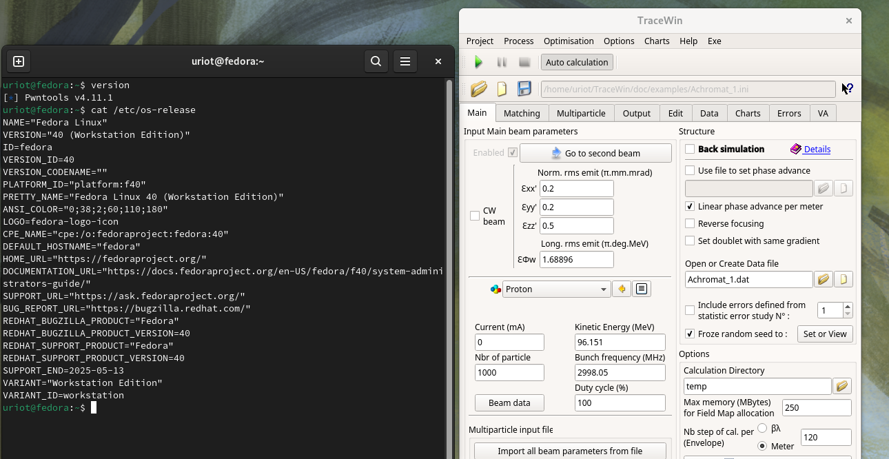

Hi Emmanuel,
As usual, what doesn't work for you works for me, making it difficult to correct what does work. :D
Image collée.png (326.82 KiB) Viewed 8619 times
