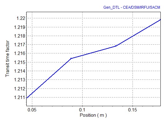

I get a very strange results from the attach DTL.
May oyu explain why I get TTF > 1 ? During the SuperFish calculations the TTF <1 it is aroud 0.6.
When I plot the results T I get around 1.2.
The used particles mass is 3726.422 MeV the q=2 (Alpha particles)
Wrong TTF!
Wrong TTF!

Dear Michele,
Could yo give me your GenDTL.ini file.

I've put the GenDTL.ini file. In my opinion the problem is connect to the particle mass definition.

Dear Michele,
Yes, clearly you're rigth and inded that was a charge 'q' missing somewhere.
Ok it's fixed now.
