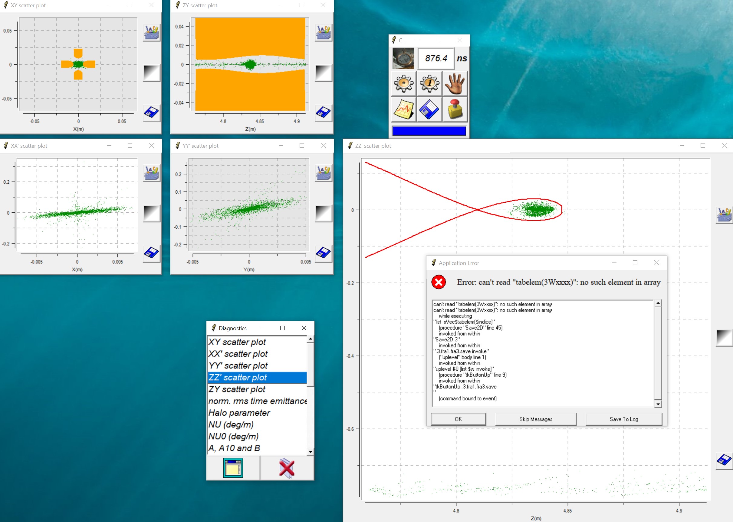

some error occures when I tried to save data from ZZ', XX' and YY' scatter plots into ASCII txt files.
What is it?
Regards, Vyacheslav.

I am Romuald, the Toutatis developer. I am currently on vacation and will look at the issue early next week. I promise.

By the way, the time for me to fix this, there is a work around with the 'RFQFINISH z' command that asks to the code to end the simulation when the beam has reached z, z is in meter. The code will export a .dst file at this location. Once you got your .dst file, Plotwin can help for further treatment including export in ASCII.

OK. I found the problem. Toutatis with the fix will be updated on web site by next week.

It takes more time unfortunately as we have also to update all versions of Toutatis for Windows, MacOs and Linux. However, if you use Windows, I can help you by sharing 2 files you would have to download and install at a specific location (bin directory). Would it help?

please find below a link for uploading the 2 files. Unzip and install the files in Toutatis/bin folder. For being on the safe side, maybe you should save your current files in a separate folder in case these new ones put you in trouble. At least, I can confirm that the fix works on my platform.

unfortunately with the fixed files programs cannot perform correct calculations.
Please, look at the attached files. Without fixed files it is obtained fig.1. What is a problem in and how fix it? With the fixed files it was obtained the result shown in fig.2. What can you advise me?
